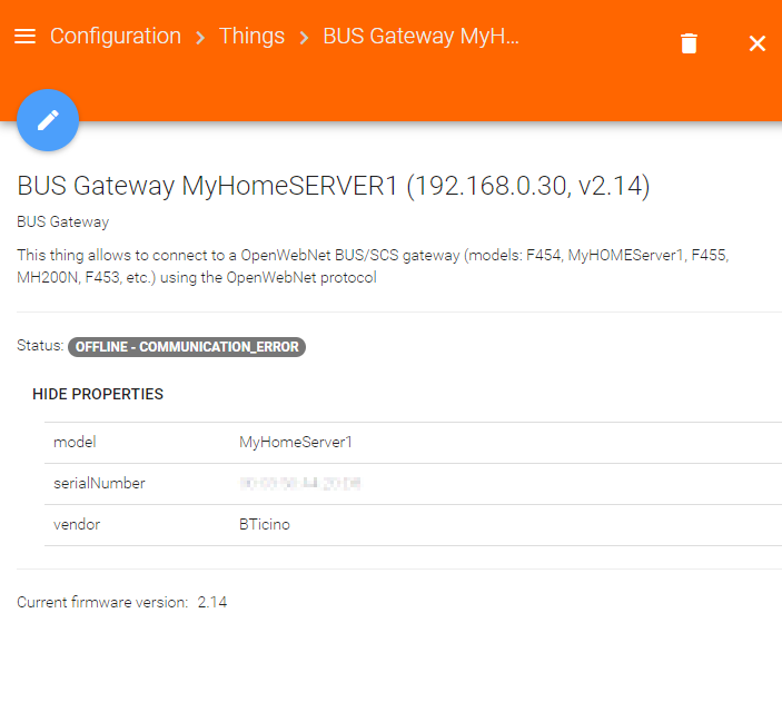

Hi Massimo, thanks for your fantastic binding. I’m still in the learning phase on how to setup OpenHAB things, items and rules to link my BTicino system on MHS1 to Google Assistant.
Right now I’m using your latest available binding org.openhab.binding.openwebnet-2.5.0.M2-1.jar and Openhabian (latest stable, OpenHAB 2.4) installed on a Raspberry 3. I’ve got no others binding installed besides the Yeelight binding. Yesterday I was trying some new rules and syncing my Google Assistant to drive some lights and shutters. I’m using text configuration for things and items (like your examples on Github).
Everything was working fine during the last months… at least until yesterday night. Starting from 2 rollershutter everything in Openhab using the openwebnet binding have stopped to function, the last thing was… the gateway. MyHomeServer1 (v.2.14.16) is still recognized from your binding and I can add it as a thing but in the log viewer I see this:

I’ve tried also to add the gateway via PaperUI:
The log response is still the same. I’ve tried to reinstall completely Openhabian on a new SD card (without Yeelight binding), tried also to run OpenHAB on Windows using Java… but the answer is still the same: gateway is no more recognized as ONLINE from the binding.
With MyHOME_Up app the BTicino system is fully functional and yes, I’ve tried to check and change the OPEN password. I’ve tried also with MyHOME_Suite and the MHS1 is recognized immediately using the OPEN password.
I’d like to try also the Openwebnet client but the official BTicino page where you could download it is now a (404 page not found. Could someone might be kind enough to upload somewhere the OpenWebNet_Client_windows_32bit.zip and post here the link?
I really appreciate any help you can provide, thanks.
Manuele.
Same situation from yesterday! Same tests and same results with 3 different gateways and 12 months of working configuration. Same results with a fresh installation with only this binding (both with manual & market installation)
Here you can download the Openwebnet Client
Luca

Version 2.5.0.M2-1 of the binding is now expired and does not work anymore after a reboot.
Due to the problems in the new openHAB build system no new releases have been possible since months (check other threads why…).
Now situation is a bit better , so I should be able to prepare a new release in few days and put it here for everybody to make an upgrade.
Massi
Hallo,
Here you are a new OpenWebNet binding release: 2.5.0.M2-2.
I suggest EVERYONE upgrades to this bining version as all previuos versions are now EXPIRED and will not work anymore after a OH2 reboot
