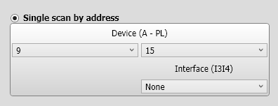

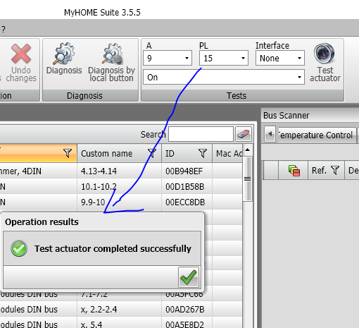

Testing non existent 9.15 adresss
Scanning for 9.15 - in case I have some hidden harware!!
They can’t both be correct but 9.15 behaves as though it really exists!!
