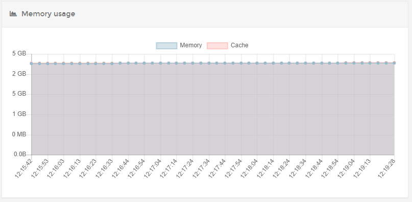

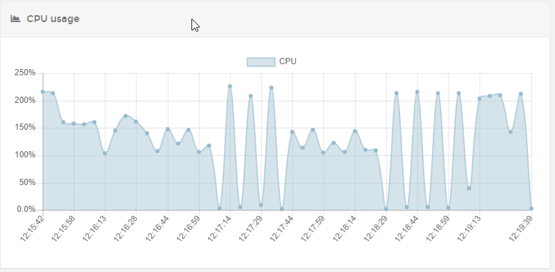

I have 3-4 GB memory usage after 1 or 2 days in docker under CentOS and zwave2mqtt reaction time is growing, it is usually around 10-30 secs. How to dig deeper with this problem? After restart memory starts at 800-900K. CPU usage inside docker container is 200 %.
I have 2 rules running one operating a zwave aeotec nano dimmer based on motion detection and another cycling my cameras with zoneminder binding each 10 seconds (this is a scripted rule). I’ve read on forum that someone had issues with IPCamera binding as of slow garbage collection not releasing images from heap and using high CPU slowdowns and poor garbage collection. How can I check that with Karaf console?

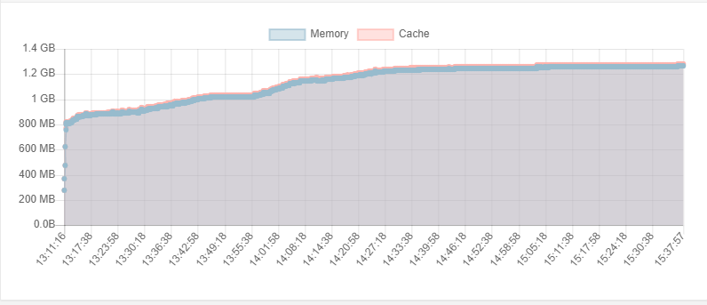

After running for two hours it has a tendency:

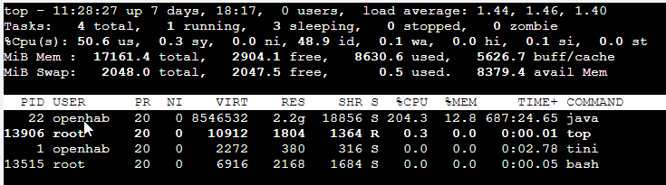

After testing for 6 days I think this may be a zoneminder binding issue. If I enable my rule to cycle 4 cameras every 10 seconds memory is accumulated and reaches 2-3 GB in a day. If I stop the rule the memory increase stops as well. CPU usage peaks only after reaching 2.2 GB memory allocation. I assume this is related to java garbage collection settings but I could not test this. If I restart OH3 with disabled rule memory usage stays at 1 GB and no CPU power consumed. Disabling other bindings or rules it has no effect on memory/CPU usage.
