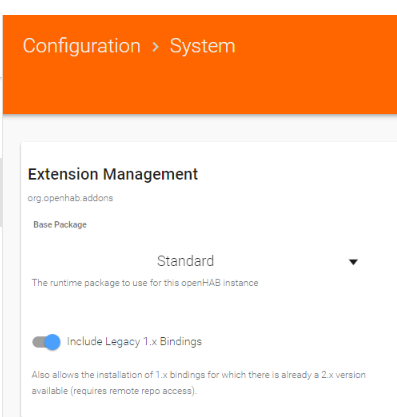

Wait, you said 1.9; but the jar file is 1.10; what am missing here? ty.
1.10 is the new one sorry. Make sure you installed the openHAB 1.x compatibility mode as well in the paper UI.
http://docs.openhab.org/tutorials/migration

What you can try is to install latest openHAB-Snapshot. Myself I’m working with openHAB 2.1.0 Build #964 and MyQ is working as expected.
The current version(1.9) included with the released version of OH2 is broken. You have to manually install a newer version(1.10) for the binding to work again. Post #152 about includes the instruction on how to do this for a linux/rasberry pi install. If you are still having issues please let me know.

echo ‘deb JFrog unstable main’ | sudo tee /etc/apt/sources.list.d/openhab2.list
and then
sudo apt-get install openhab2
will it automatically pull the latest snapshot in this case?
thanks do I still need the openhab2 snapshot version or the stable is ok? i will try the steps in #152.
where can I find myq.cfg for this snapshot.jar? I have done what is outlined in#152 and started openhab but i dont see myq.cfg under /etc/openhap2/services anymore.
If you install the stable version of OH2, then you have to follow the steps mentioned in post #152 for the new myq binding with the fix. The snapshot version already has the fix for the myq binding. If you install the snapshot version you can just install the myq binding from the paperUI and it should work out of the box.
You may have to create the “myq.cfg” file manually in the services directory. The only required parameters are username and password. I would restart OH2 after these changes, just to be safe.
username=xxxxxx@xxxxx.com
password=xxxxxxxxxx123
whoo hoo. got it to work after installing the snapshot openhab2. mycfg created automatically when enabled thru paper ui. now the items and sitemap shows in basic ui but not in paperui. any idea why?
