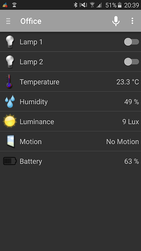

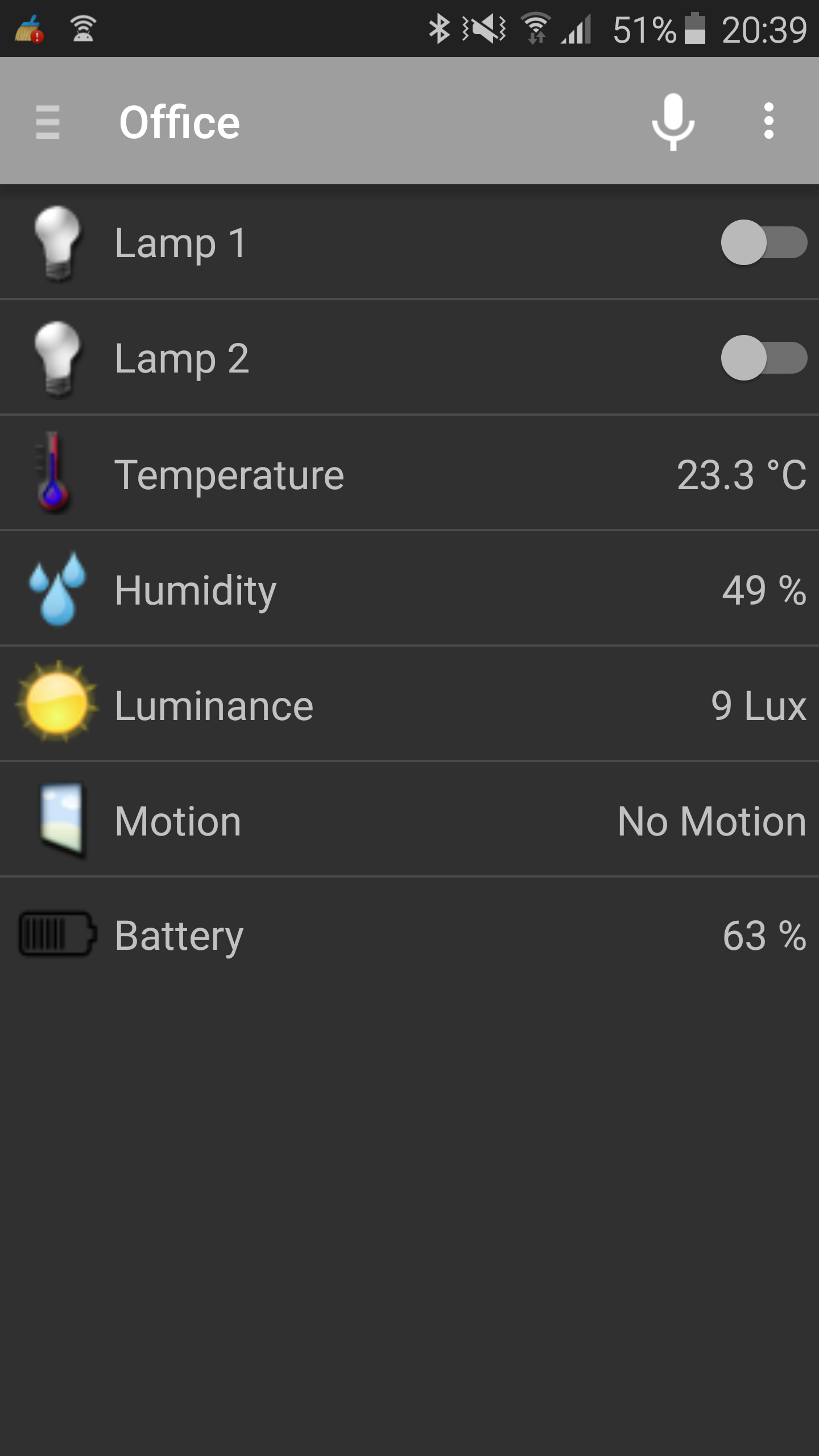

I’m also using the Aeotec Multisensor, but I can’t make it work. It seems to randomly send values.
Most often I get battery, temperature and motion but I have never seen any values of humidity and luminance.
Note that the multisensor does not send these values by default - you need to enable them in the configuration of the sensor (ie in HABmin). I think it’s normally parameters 100 to 103, but take a look at the manual - it should tell you there…
Chris

I have two of them working in my setup. Here is what I had to configure in Habmin. On Configurgation tab, Binding, z-wave binding, expand to your Aeon multisensor node, expand Configuration Parameters.
3: On Time: 30 (this is just personal preference of 30 second reports, I wanted to see how long the battery would last. so far have 58% left after about a month and a half.)
4: Motion Sensor: Enabled
5: Command to send when movement: Send binary report
101: Which reports to send automatically in timing to group 1: 225
102: group 2: 0
103: group 3: 0
111: Interval to send out reports to group 1: 240 (also personal preference for testing battery life)
112: Interval to send out reports to group 2: 720
113: Interval to send out reports to group 3: 720
Hope this helps get everything working. I found those parameters on someones guide when doing a google search :smile:
