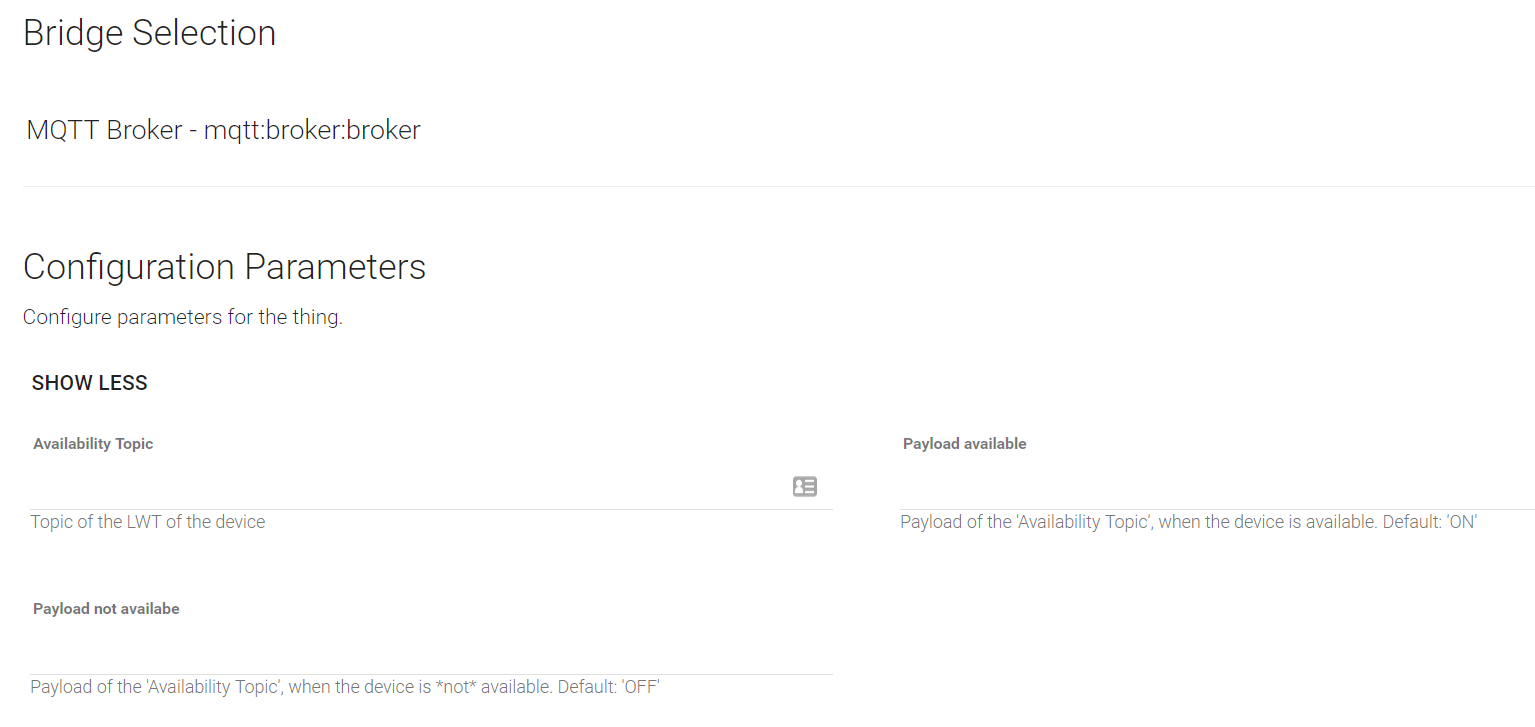

There is yet another way. I can’t (and wont) look up how/if this can be done in .things files. But when you create the Thing through the UI you get three parameters on the Thing for handling the LWT.
  • Availability Topic: zigbee2mqtt/yourDeviceFriendlyName/availability
  • Payload available: online
  • Payload not available: offline
Assuming thazigbee2mqtt publishes these messages as retained than the binding will mark the thing as OFFLINE when the LWT topic says it’s OFFLINE. And all Items linked to that Thing’s Channels will be set to UNDEF similar to how it does when the MQTT Broker Thing goes OFFLINE.
Yes, good point!
I can confirm:
Personally I prefer to have the status in an Item - I find it a little easier to work with in rules, and of course the Sitemap. But I can see the logic behind embedding the LWT in the Thing itself!
In rules and such you would just check to see if one of the other Items linked to the Thing is UNDEF. This covers both the case where the broker reported the device as offline through the LWT and the case where the broker Thing itself goes offline.
