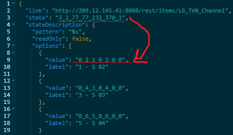

What I’m trying to do is to get the name of the current TV channel from the webos binding.
Actually this is my problem LGWebOS Binding (for LG WebOS TVs) - #790 by LaurentiuB
The
String LG_TV0_Channel "Channel [%s]" { channel="lgwebos:WebOSTV:tv1:channel" }
Returns this
But I need the “label” not the “value”, that’s why I was using jq
