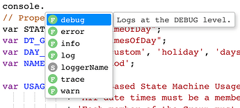

If you have suggestions for what could be added to the editor to help we are more than open to pursuing it. We are not under the impression that everything is super easy to understand and use so if there’s anything we can do to improve things in the UI we should.
Blockly is a little more intuitive because you get the menu on the left with all the blocks you can use. But for text based scripts indeed, you end up with a blank screen.
Maybe pre-populate it with a comment and the URL to the reference docs for that language, or add that to the bottom bar?

What would have helped me get started quicker would have been a link to the library docs. For the beginners a note that pressing ctrl-space brings up a context menu of options might be nice too.
Now, a slightly more difficult thing would be slightly more debugging options. Having a sidebar (or a terminal-like window at the bottom) to show console output or the like would be nice. I’m fully able to ssh into my OH instance and tail the logs, but many people wouldn’t be at first. And hell, I’d use that too because it’s faster. Bonus points if it only shows output from the rule you’re developing. I can see that being nice if you have lots going on in your logs.
