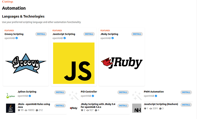

I’d like to throw in my favourite scripting language, especially for openhab, and here’s some comparisons:
I suspect for JavaScript it’s the yellow JS, while JRuby has two options (in my 3.4 install).

If I go JS, which of the two to use (to satisfy my longevity / support requirement)?
Anyway, I should read the documentation that popped up when hitting “read more” :slight_smile:
For JRuby, long story short: you should install the official one that says “openHAB [blue tick]”
The other one is from the marketplace, which comes with jruby 9.4, at the time it was decided to keep openHAB 3.x with jruby 9.3 in the official distro.
openHAB 4.x distro comes with jruby 9.4 by default.
This doesn’t affect your script unless you plan to use new Ruby 3.1 syntax. The helper library is compatible with both.
Since you’re going to upgrade to openhab 4 anyway, it doesn’t matter, and it would be simpler if you just chose the official addon (the one with the blue tick) because then it would be upgraded for you when you upgraded to oh4.
