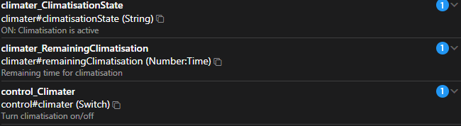

I made a simple display page in the UI
All the values returned from the car are updated correctly. :smiley: I can also turn the A/C and the charging on and off with the switches. However, a revised temperature set on the slider is not written to the car.
More importantly for me, I cannot control the charging rate. The value of charger_MaxChargingCurrent should be adjustable over a range of currents
However, the car continues to charge at the rate (10KW or 6KW) as set in the car, even if I stop and reset the charging with the control_Charge switch, Should this work?
