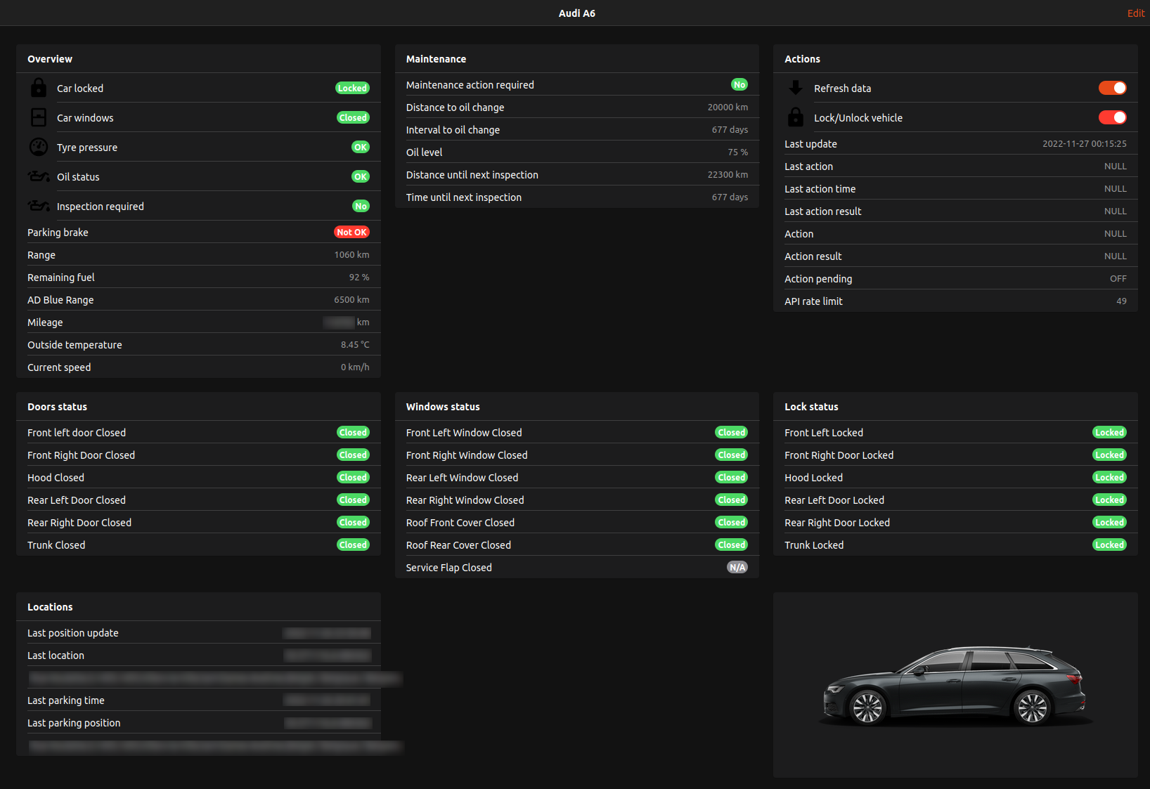

In case anyone is interested, I created a dashboard for my Audi A6: Openhab connected car dashboard Ā· GitHub
I’ve also attached a sample config for the link with item names / channels.
It looks overall like this:

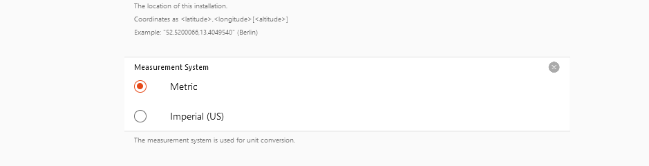

Lookking for a little help, everything works great but the vaulues are in Km instead Miles. i thought this uses the the system regional config info. any help on resolvoing would be greatful
Many thanks
