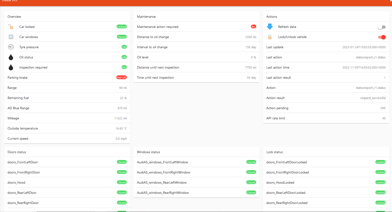

Just adding to say that I am using this binding (October 1st '22 version) for quite some time already and that it is still very useful and working for my Audi although some channels went missing over time such as parkingBrake, tempOutside and the window positions (not the most important ones fortunately).

everything seems to be still working for except Outside temp & Parking brake
