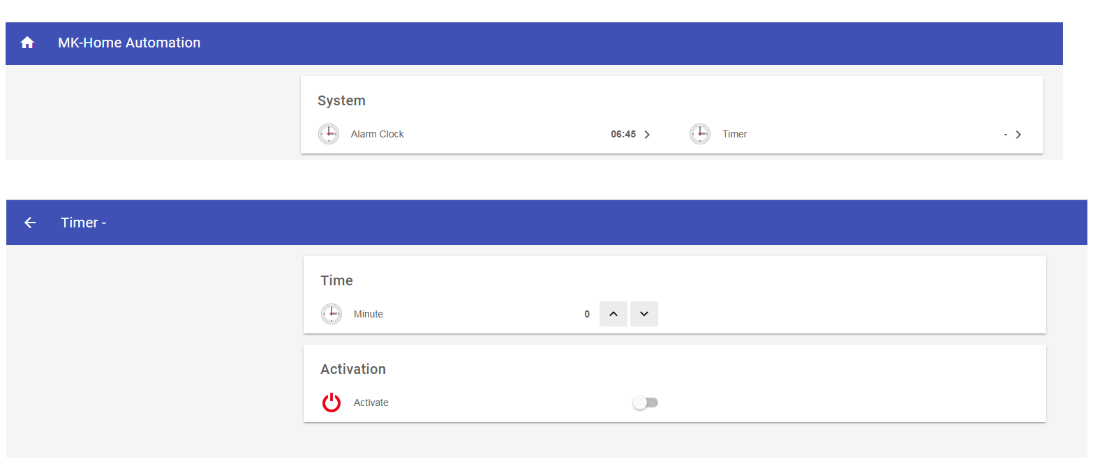

sorry for the confusion, I’m trying to create a sitemap with some switch items. but i also want to have a timer option for that switch. ex: trigger the switch after a certain amount of minutes.
The Timer Item
is just made up of a SetPoint (named S1) to set the number of minutes needed and a Text(T1) to display that and a switch(SW1) to activate the timer.
so my question is that do I have to always repeat the same process of adding a new SetPoint(S2) and Text (T2) and switch (SW2) or can i group those 3 items into something which i then use an instance of (like a class in OOP languages)

The Text is just there to display the set time.
The Timer in the Main screen (first screenshot) would display how many minutes it was set to that’s all.
