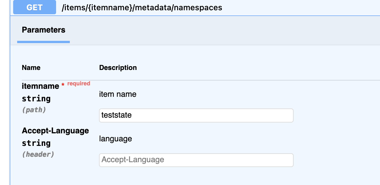

Unfortunately I didn’t get that far because we didn’t know what the impact would be changing it as it would break the API because it behaves the other way around as it is currently doing BUT the way you can achieve is the new API endpoint which I provided today on 4.0:
which returns all the metadata namespaces of that item:
“commandDescription”,
“testNamespace”,
“semantics”,
“stateDescription”,
“rollershutter”
You can then use this to retrieve the item with the metadata. There is also another PR open (where you can also see this in action) that will then show all the metadata in the UI (which is actually why I added the new endpoint) which you can find here:

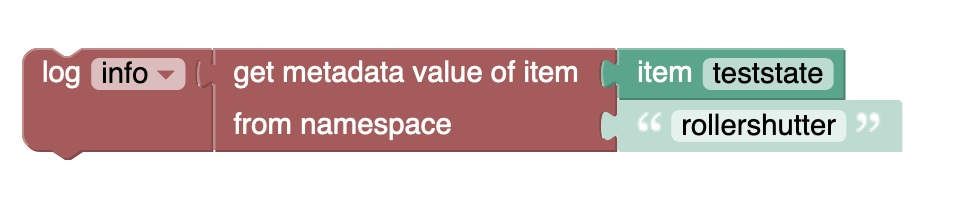

I know, Rich, Florian and I worked together on that lib (at let’s say I verified it) because it becomes the basis for the new blocks.
creates this
console.info(items.getItem('teststate').getMetadata('rollershutter').value);
So, the blocks will be there soon but a simple Widget that would allow to edit these, is missing.
