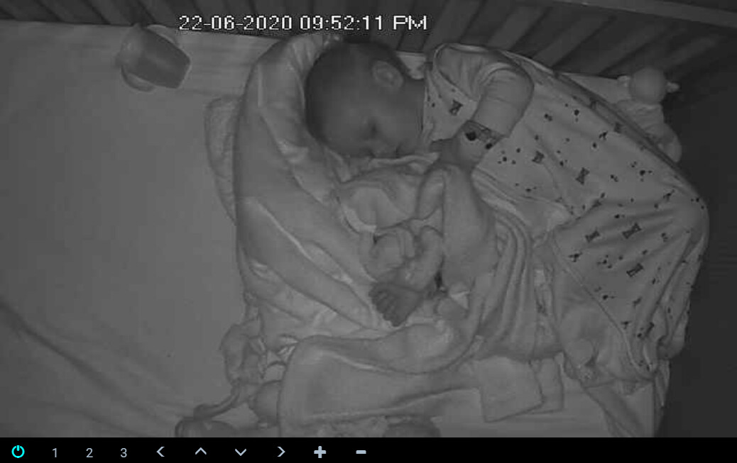

This is my first attempt at creating a Habpanel widget, so feel free to suggest changes and mod it to your needs. All styles have been left off to allow any css or themes that you choose to effect how this looks. If you have improved it in any way then please post a picture.

i have that exact smart device , how did you get it to go to sleep at 9:52 :stuck_out_tongue_closed_eyes:
He’s only pretending, he knows that I am watching :grin: Yes they are a very smart device.
