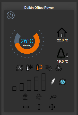

I have created a custom Widget (for the HABPanel) to control my Daikin Units.
A first draft version is working fine on my OpenHAB (Running on a RPI 4).
It can be used to:
  • turn on/off the Unit, change the target temperature,
  • display the indoor and outdoor temperatures,
  • set a mode Auto, Fan, Dehumifier, Cooling or Heating,
  • set a special mode Eco, Powerful or Streamer,
  • set the fan speed on Silent, Auto or level 1 to 5,
  • set the blade direction on horizontal, vertical or both
image image
I would be glad to have some feedbacks (support on other devices, missing feature, user experience, …)

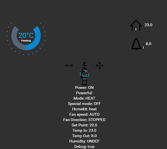

Hi, your widget looks great. I am just having some issues with everything displayed on top of itself. Any ideas? I think I have everything right. The only item I don’t have is humidity but cant see that affecting anything in the widget.
Something that might help is I see this in the browser debug
/static/vletroye/images/daikin_mode_%7B%7Bindex%7D%7D_on.png
/static/vletroye/images/daikin_fan_LEVEL_%7B%7Bindex%7D%7D_off.png 404
/static/vletroye/images/daikin_fan_%7B%7Bindex%7D%7D_on.png
/static/vletroye/images/daikin_fandir_%7B%7Bindex%7D%7D_on.png
Any help would be greatly appreciated.
Cheers

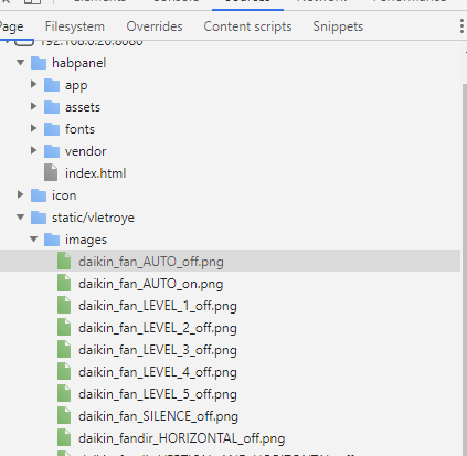

Here under, we can see that the browser fetched correctly the images. Do you see that too in Sources tab of your DevTools (Chrome) ?
I am not an expert (I mainly did copy/paste of code found in the community). But it seems that the tag is rendered a first time without/outside the context of “ng-repeat”. In such a case, it’s made explicitely with the url “/static/vletroye/images/daikin_fan_LEVEL_{{index}}_on.png”, without replacement of {{index}} by a value ?!?
