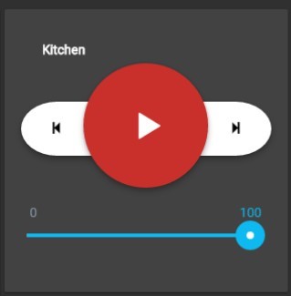

Thought I’d put together a Music Control Widget that had everything in one widget.
It uses two items
Dimmer Kitchen_Volume "Volume"
Player Kitchen_Music "Music"
Widget settings are
action_item = Kitchen_Music
status_item = Kitchen_Music
my_name = String value (Speaker Location/Name)
volume = Kitchen_Volume
step = Number value (volume increments)
Credit to @ysc lot of the widget code is from one of his screen shots in a post
Custom widgets: feature walkthrough - HABPanel - openHAB Community
Hope it is of use to someone.
MusicControl.widget.json (3.3 KB)

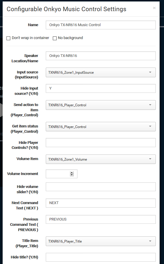

Inspired by the fantastic work of @Murpher I use his Music Control Widget for controlling Spotify Connect on my Onkyo TX-NR616.
Since the Onkyo has several item-channels I made some adaptions to @Murpher 's great original widget. So many thanks to @Murpher
Extra item-channels (available on the Onkyo) that I added:
  • Song Title
  • Song Artist & Album
  • Song Playing Time
Configurable display of items
Since displaying all these channels can make the widget too big on my UI, I made all the items also configurable. So I can choose what to hide or display, even the (volume) controls ( when ever that would make sense… :fearful:). Perhaps this can make the widget also useable on other receivers with lesser item-channels.
OnkyoMusicControlConfigurable.widget.json (5.7 KB)
