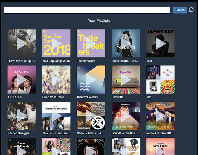

Wanted to have some minimal control via Openhab without reverting to Spotify client, so created a custom Spotify Widget from which you can play your playlists on selected player (also supports simple spotify search).
This is client-side only widget (habpanel only). Minimal testing done on modern Chrome.

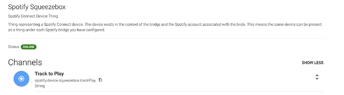

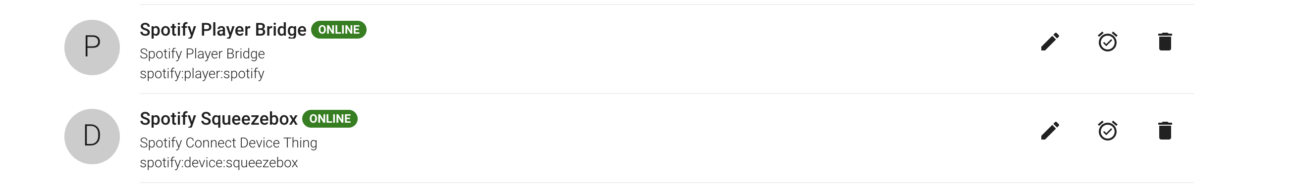

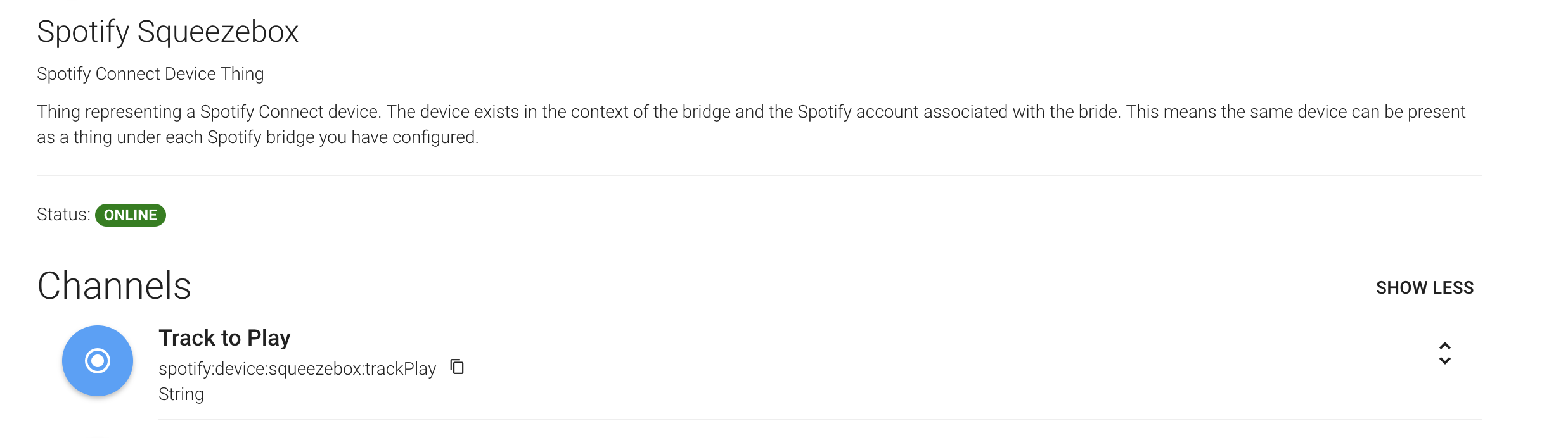

Yes, you need a player set up. E.g. I have a Squeezebox player which is configured as Spotify Connect Device thing which has a channel “Track To Play” (note that you have to click ‘show more’ because it is hidden initially’:
This is how my paper ui config looks:

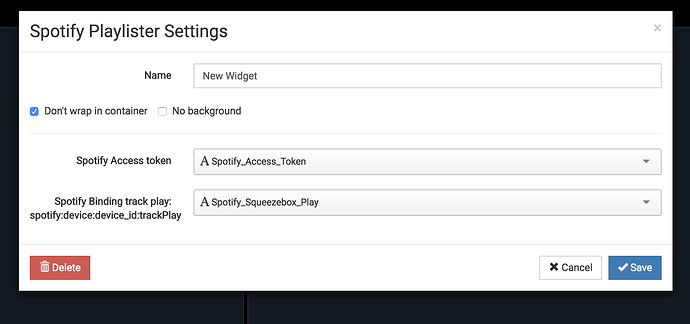

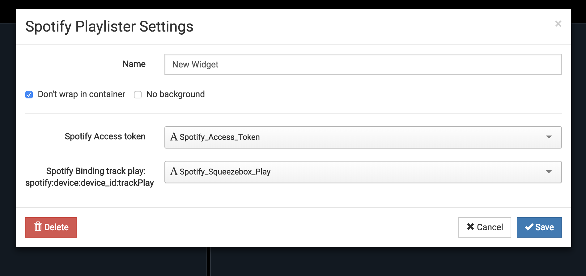

And my widget config then:
Yep!
