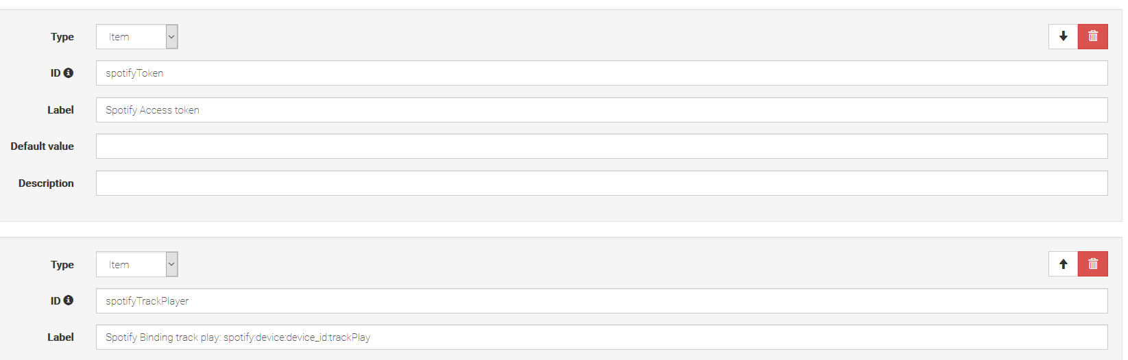

I have the following items. Placed them into the Widget, like so, but I get an error . Ive created a new String called spotifyTrackPlay, but again, same issue. Tried many things! Would be great if you could put a bit more detailed information in the Readme about how to get this to work as it looks fantastic.
String spotifyToken                                {channel="spotify:player:a54a8a62:accessToken"}
Player spotifyTrackPlayer                                {channel="spotify:player:a54a8a62:trackPlayer"}

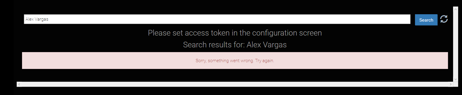

Hey, I set up the Spotify Playlister, exactly like you. I can use the Spotify Bridge in the control panel of PaperUI, but when I configured the widget, it only says “Sorry, something went wrong. Try again.” But trying again doesn’t solve the problem :smiley:
I cannot see any playlist. Checked everything twice. Dunno where I’m wrong..
I would appreciate any help.
I think this might have to do with a missing accestoken. I did fix some issues some time ago, but had not updated the market place binding (2.5.0.M2 release should be fine) for openHAB 2.4.0. I just updated the market place binding. So if you reinstall it (It should show once installed: Beta 06/09/2019) and try again.

now at least it shows something. but now it keeps asking for the access token, even though its set in the settings and the item does work in the binding. exactly as @dastrix80 has in post 26

Exactly, there is a mismatch of the description stated in guthub and the settings, which actually needs to be set in OpenHab2.
You find the Access Token by showing more details in your bridge and by linking the access token to an item, as stated by Artropos.
Second step: The “spotifyplaylist” item, which belongs to the binding, needs to be connected in the config of the HABpanel widges as Spotify Binding track play.
Hope this helps others to fix it. Now it works for me.
