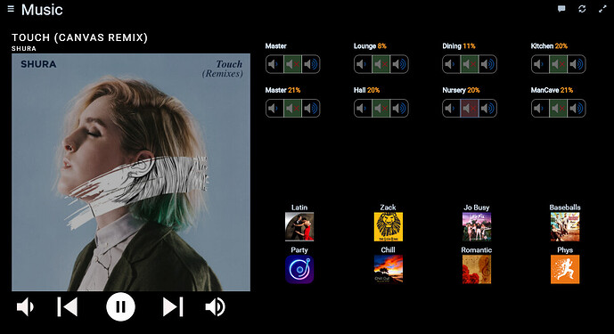

I’ve been playing with Habpanel widgets to create a Dashboard for Sonos. Attached are 3 widgets which link to my Sonos system of 7 rooms. All are extensively reworked from other people’s versions for similar things and I’m no expert at coding so I’m quite sure they can be improved on!
There are three widgets:
SonosControlWithArt shows AlbumArt and does player controls and volume
SonosControlWithArt.widget.json (10.1 KB)
SonosAlbumSelect shows 8 slots which link to Sonos favourite playlists (or stations etc) with a link to png for Album cover
SonosAlbumSelect.widget.json (7.0 KB)
SonosSystemVolume groups different speakers (I use the one called SN_DiningRoom as a master) and controls the volume. The top right master one runs buttons called Chill and Loud which run rules which set all speakers to a pre-determined volume for background music and party mode. This one is a bit more complicated and I can post more detailed instructions if helpful to people!
SonosSystemVolume.widget.json (18.3 KB)
Hopefully of use to someone - improvements and code tips helpful as learnt from scratch through copying and guesswork!!

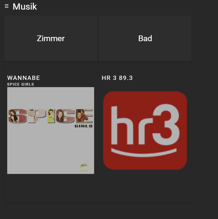

Could you please explain how to start Sonos favourite playlists or stations.
Last time I got trouble by playing my favorite tunein radio stations. So I decided to switch to radio.net.
There are no problems using them via sonos app, but for me it is absolutely impossible to start them via openhab.

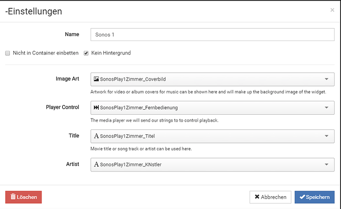

i install and config the Widget 2 but i cant see the music/volume control icons.
They are control the music but i cant see them.

Thanks for trying this! Bit of a guess but it looks like the widget isn’t big enough - on mine it covers a whole page. Click edit and make the widget taller and wider.
The Widget looks great. But I don’t see the control neither. I tried to resize the widget but the never appear.
Do I have to put the control images like Play.png into the folder /static/sonos/? Where do I get them from? Is it located at /etc/openhab2/html?
Regards, Fred

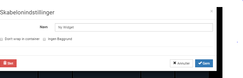

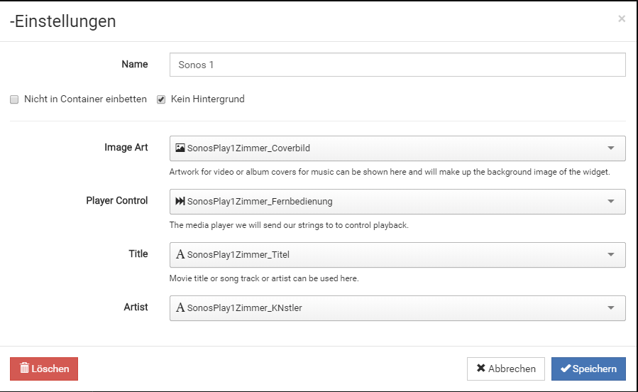

when i follow your guide clicking edit give me this
Hi there. I think this is the wrong widget - it should have more options and also mine isn’t in German.
Hi Fraser
I managed to get to next step.
  1. Link to the appropriate items - explanation of the item type is shown, they need to be the right type - image, controller, string, string respectively
This is is teasing me a bit ,since when i am defining tyoe image and controller is not an option.
