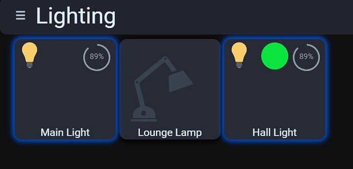

Custom Widget: Switch-Dim-Color
This widget can do Switch, Dimming and Color picking all in the one space saving design.
Click on the tiny knob and the modal control appears allowing a change to be made.
Click on the colored dot and the colour picker opens up in a modal allowing a change to be made.
Click anywhere else and the item turns on or off.
Since the controls that you don’t want can be hidden, you can use this to still control Fans, power outlets or anything else you wish.
TIP: You can change the shadow to any colour you like so this feature could be used to have all lights as 1 colour and all power outlets coloured with a different shadow. The shaddow format config is used for this and a post below explains its use.
Using the ‘Plump Dark’ CSS
Using the ‘Plump White On’ CSS
Widget Json code
Switch-Dim-Color.widget.json (6.9 KB)
For more info on what to do with the css files, see this thread..

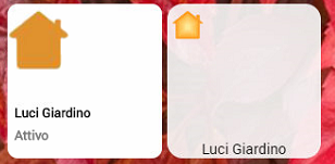

finally i’ve tried everything and it’s almost perfect! just 3 questions:
is it possible to make your widget to look like the one on the left?
i mean move the item name (and make it in bold) a little bit high and aligned to left and also add the status of the item below the item name. also if is possible to increase the icon dimensions on the top left.
anyway, you did a fantastic job! next step is to make the widget for thermostats :wink:
You can easily do all those thing if you learn CSS, it would take you a few hours at the most. Have a look at the switch-glowing lines in the css files I provided and the absolute positions are what your after. The only things that would need a change to the widget are the icon size and the status, the rest are all possible with css tweaks. You can try the two css files to see how easy it is to create a new look. You can create a third.
