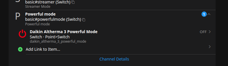

What I’m interested in most is the “Powerful Mode”. I already saw it in the JSON dump:
"powerfulMode": {
  "settable": true,
  "requiresReboot": false,
  "value": "off",
  "values": [
    "off",
    "on"
Unfortunately, when I’m implementing an Item Switch for Powerful Mode, nothing happens. There’s also no error or any other log entry when switching.

Hi Dandjo,
The binding breaks because it tries to process the cooling data and this does not exist with your heat pump. I will fix this.
As for the Powerfullmode data is located in the Json that is not yet used and supported. At the moment I am working on making the binding as good as possible for the air conditioners(“climateControl” part of JSON). Powerfulmode is a property of the hot water tank(“domesticHotWaterTank” part of JSON). I’m still trying to figure out what the best solution is for this.

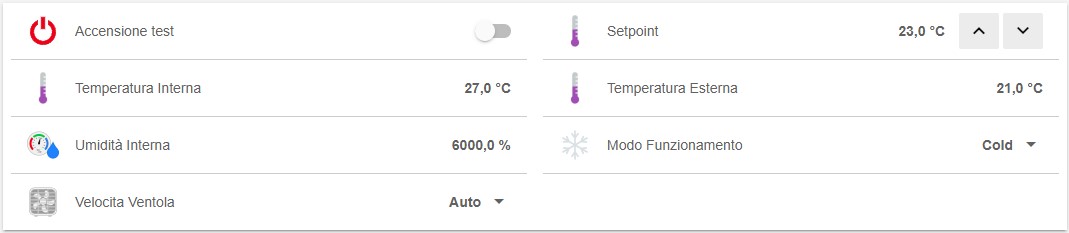

why if i put this code i have this result:
Number:Dimensionless		DaikinACUnit1921681140_IndoorHumidity 		"Umidità Interna [%.1f %%]"		<humidity>

Hi Marco, I don’t know why this is happening. If you Google it you will find more issues with this. Maybe you can create a script with a division by 100
There are some tricks concerning UoM you should know. I just had to learn them, too. If you change from a different data type to Number:Dimensionless the actual existing data will be shown in a confusing way. I had exactly the same result as you have for a humidity item I was playing with some days ago. But you simple have to wait for a new reading and the new data will be formatted correctly. And then also your graphs will be correct, …
Another trick has to do with the unit meta data. For a percentage you have to have a % as a unit meta data. But if you change the data type to Number:Dimensionless and get back from the edit page to the item page and want to add the unit meta data, you might not be able to do this as there is no unit meta data available in the list of known meta data. The list starts with State Description. You have to leave the item page first and then get back to it, to see the unit meta data in that list.
