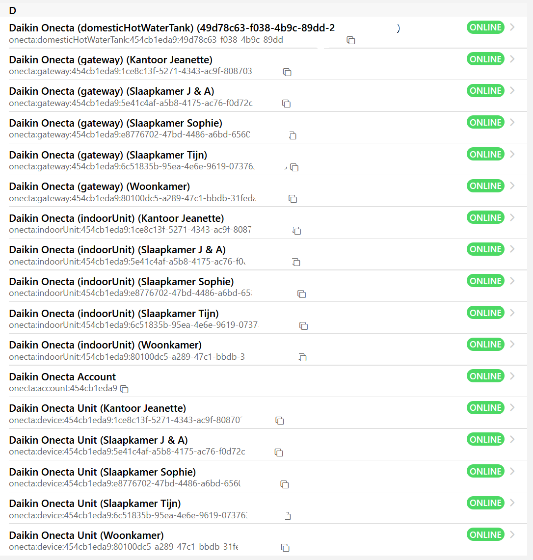

Discovery
The bridge can be added using the UI or can be configured with a thing-file and items-file.
Once the bridge is set up and connected to the Daikin cloud it will receive all information about the connected units.
Based on this information it will recognize the different units.
All recognized units end up in the Inbox, are listed in the logging and in the UI they are shown in the thing properties.
Things that can be discovered are:
  • account: The bidge ensures the connection to Onecta cloud and the recognition of connected units
  • climate-control: The unit itself. With this items like climate can controled.
  • gateway: The network controller of the unit.
  • IndoorUnit: Gives information about the indoor unit.
  • domestic-hot-water-tank: Is the thing to control the Hot water tank.

Screenshots
