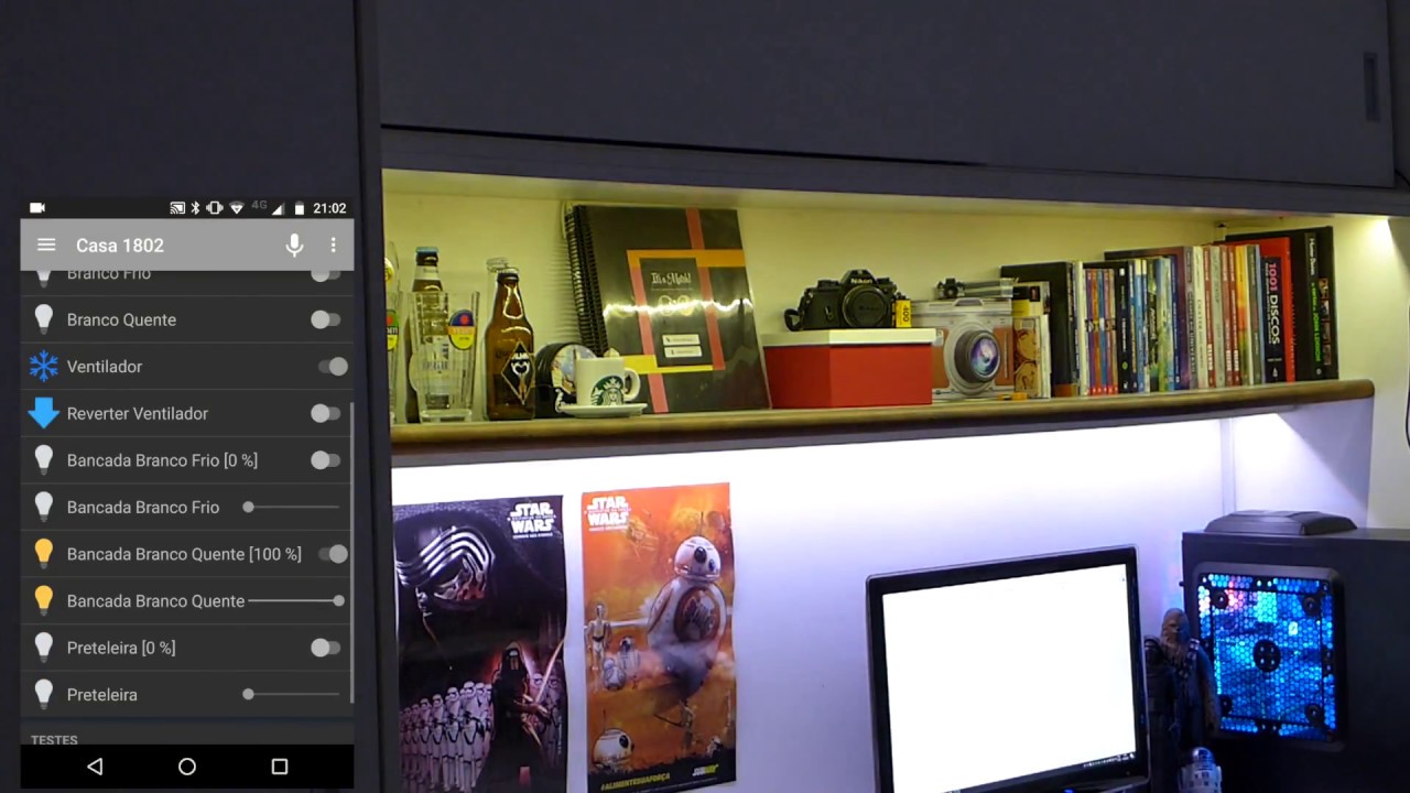

I’ve posted a quick video showing the features that I’m currently using with my openHAB system.
It includes MQTT communication (with arduinos controlling PWM Leds, Fan, Bulb Lights), Voice Commands, Google Assistant Integration (With IFTT) and finally Kodi and Chromecast integration.
I’ve used my own case as a subject of my Electronic Engineering final dissertation. Unfortunately it’s only in portuguese for now, but I’ll improve and translate it soon.
