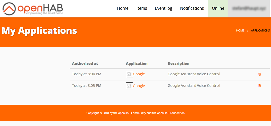

Hi Bartus,
EDIT: I tried it a third time, then it worked :wink: Below you can find the original issue.
EDIT2: I think I know what the problem was. In PaperUI I exposed the items for “apps” (like Google) too late.
in another thread you told me that support for German language will follow, but I was very surprised to see in my google home app (on my smartphone) that openhab is listed as an available plugin.
So I gave it a try without success:
As described in your video I added the [ “Switchable” ] tag to one of my items (a Sonoff tasmota mqtt switch).
I connected my local openhab with myopenhab cloud and can successfully use the habdroid app.
Then I added openhab as a “device” in google home app on my smartphone, as described in your video.
BUT even though myopenhab.org lists “Google” as connected application (see screenshot below), I don’t see any devices on my smartphone (google home app). So I added openhab as “device” again on the smartphone and now I see Google twice listed in openhab.org but still no devices on the smartphone :-/
Any idea what’s wrong? Does this mean that German is STILL not supported?
