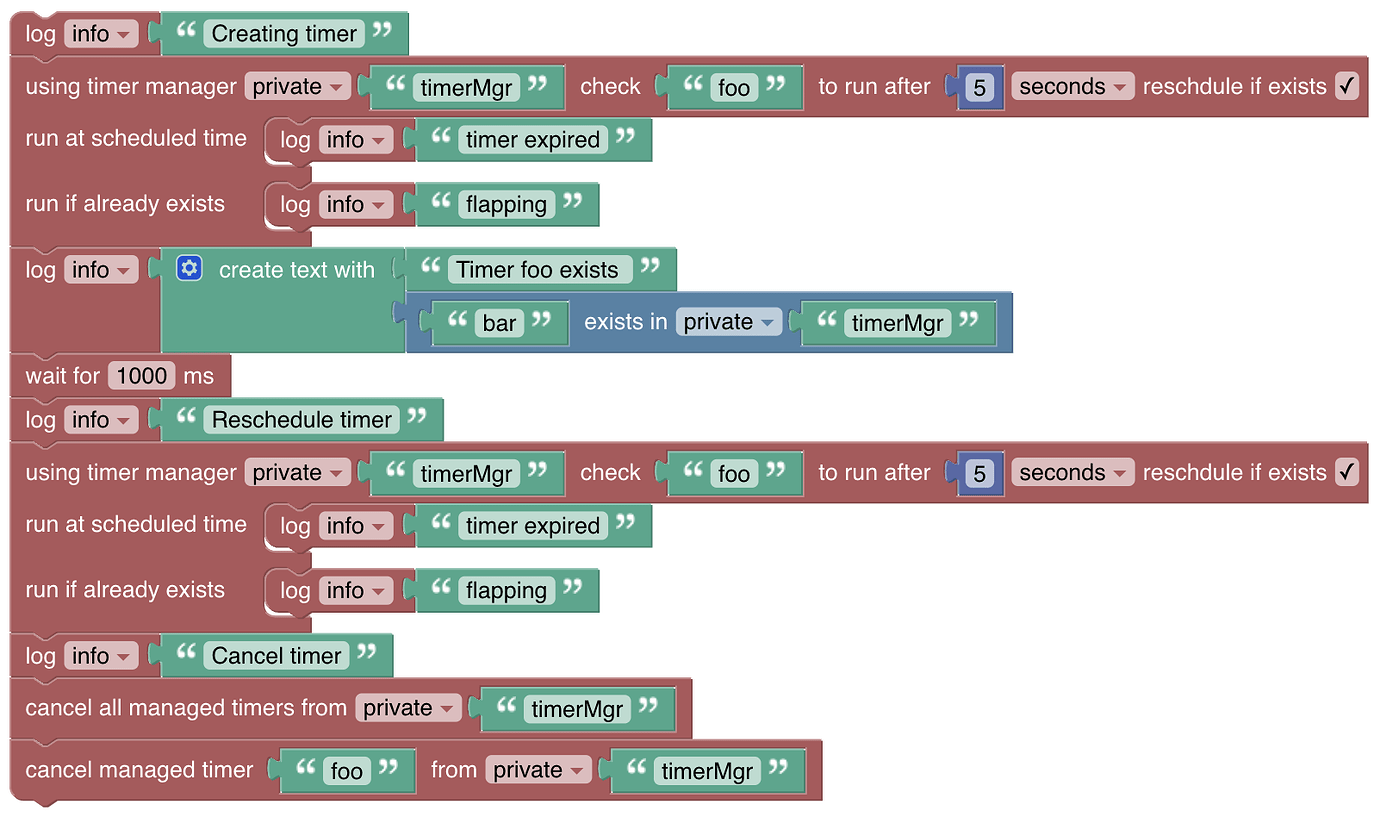

Blockly
openHAB Rules Tools [4.1.0.0;5.9.9.9] provides a timer manager block.
See the docs for the library for more details. The block creates a TimerMgr in the given cache with the given name. It checks to see if a timer by the name “foo” already exists. If “reschedule if exists” is checked it will reschedule it and any blocks next to “run if already exists” are run. If the timer doesn’t exist, the blocks next to “run at scheduled time” will be run after the given “after”.
