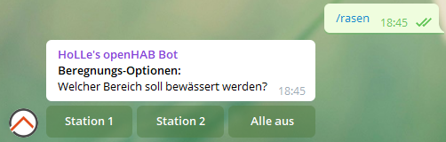

nope… i also tried this… this is resulting in
[Station 1All OFF, Station 2All OFF]
But i want
[Station 1, Station 2, All OFF]

So for now i created a dummy item:
Switch OpenSprinklerAllStationsOff "Alle aus" (gOSPI_Station)
and kept that line in the rules:
val reply_buttons = gOSPI_Station.members.filter[ i | i.state != ON ].map[ label ]
this is the result i was searching for… but requieres such dummy item… but i can live with that… maybe this will help me with the second part of the rule for the telegram answer :slight_smile:
Thanks all for you help :slight_smile:
