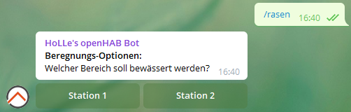

Hey @rlkoshak and others…
i try to simplify my rules for the OpenSprinkler Telegram rules i wrote to get the label names from the items file… and also to get the buttons in the amount of stations that are not OFF
OLD part:
val OSPI_ReplyId = "OSPI_Reply"
var StationDuration = 600 // 10min
val Station01 = "Rasen oben"
val Station02 = "Rasen Hang"
val StationOFF = "Alle aus"
rule "Telegram Bot receive rasen"
    Item TelegramBotLastMessageDate received update
    val telegramAction = getActions("telegram","telegram:telegramBot:bot1")
    if (TelegramBotLastMessageText.state.toString.toLowerCase == "/rasen") {
       telegramAction.sendTelegramQuery(Long::parseLong(TelegramBotChatId.state.toString), "*Beregnungs-Optionen:*\nWelcher Bereich soll bewässert werden?", OSPI_ReplyId, Station01, Station02, StationOFF)
New Part:
    val reply_text = "*Beregnungs-Optionen:*\nWelcher Bereich soll bewässert werden?"
    val reply_buttons = gOSPI_Station.members.filter[ i | i.state == OFF ].map[ label ]
    logInfo("OSPI_Reply", reply_buttons.toString)
       telegramAction.sendTelegramQuery(Long::parseLong(TelegramBotChatId.state.toString), reply_text, OSPI_ReplyId, reply_buttons)
Now here comes the part where i could need some help…
the reply_buttons i generated in the correct amount of stations… and for each name it is created the button in the telegram chat…
Now i want to add the val StationOFF to that String so that this button is also generated…
any tips on how to achieve that?
One approach could be to create a dummy item and also add it to the group gOSPI_Station, but i want to avoid that.
/Holger

Rich, thanks for your help.
No not 2 strings:::
my line
is resluting in this
2020-08-19 18:07:31.988 [INFO ] [se.smarthome.model.script.OSPI_Reply] - [Station 1, Station 2]
Station 1, Station 2 are the labels of current gOSPI_Station members (which will be more in the future)
and beside these Station names… I also want to append the String with “All OFF”
how can i add this to the val reply_buttons
