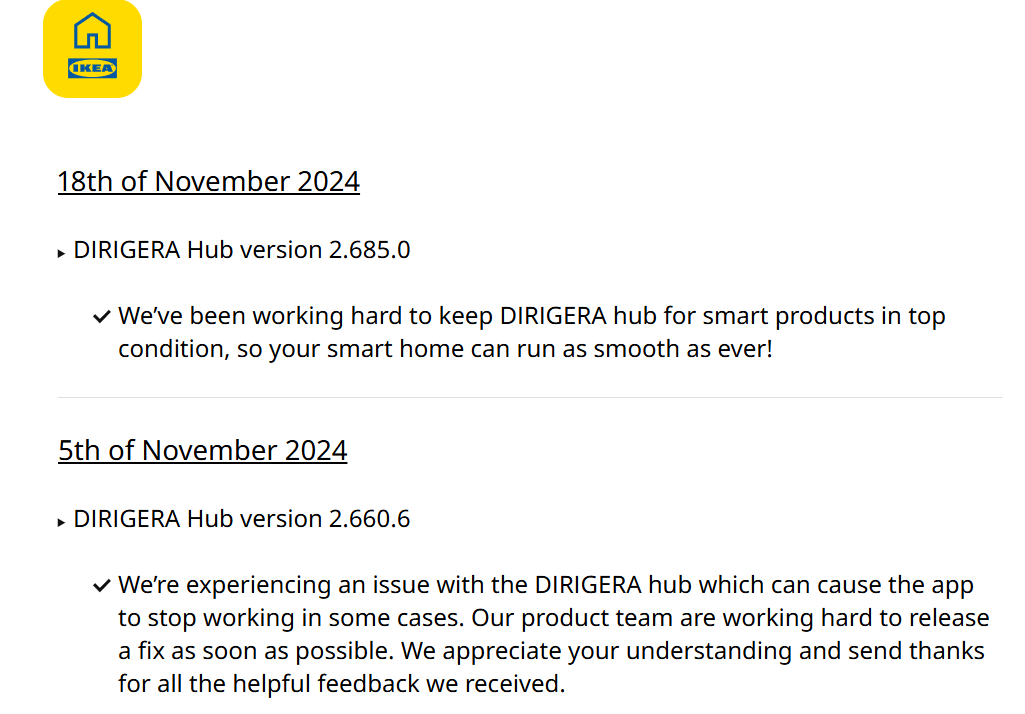

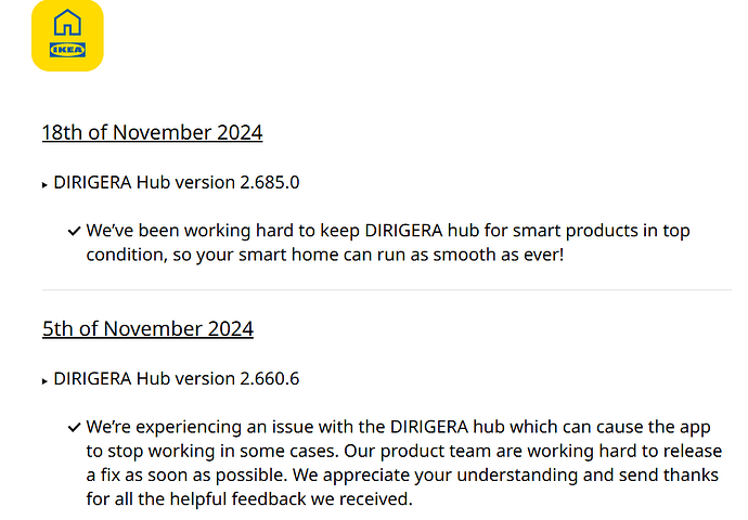

I fully agree: stability and reliability are causing me the biggest headache right now! I see DIRIGERA gateway is going to some kind of Stealth Mode after a while. Calling gateway directlly via API it says everything is fine, websocket is up and pings are answered. In reality it doesn’t give updates anymore.
This is also fitting to IKEA Release Notes from Nov 5th:
The update from Nov 18th is also not promising. The sentence We’ve been working hard translates to me We’re not finished yet!
