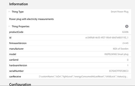

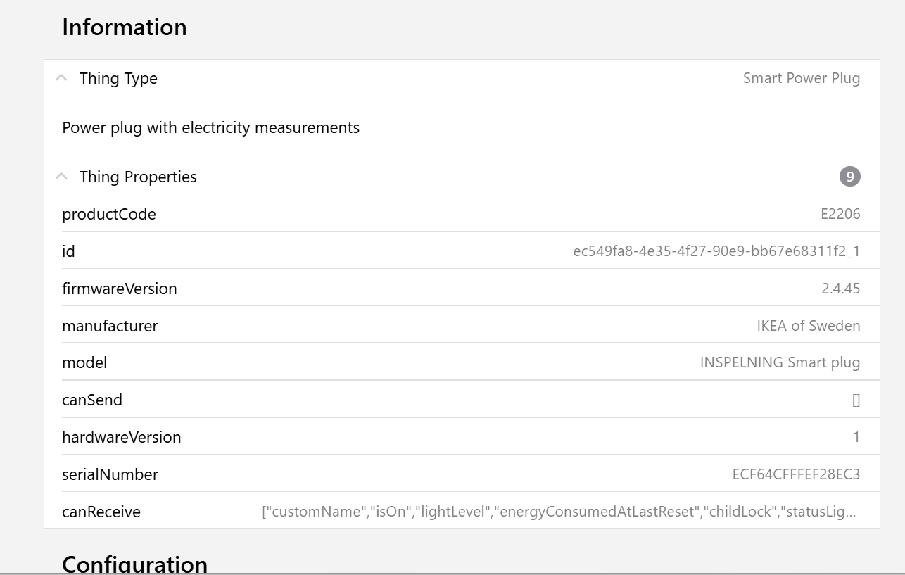

First of all, thank you for this excellent binding! I am currently facing an issue with adding INSPELNING plugs (not sure if it matters, but it is the Swiss type 12 / 13). In the DIRIGERA app with hub FW 2.753.0 they are correctly identified as INSPELNING (with power measurement, plug FW 2.4.45). In OpenHAB 4.3.5 they are showing up as simple-plug without any measurement possibility (I tried to add them manually as smart-plugs over the *.things file, but no success). Is that a known issue, probably of the DIRIGERA FW itself?
Let’s see. First can you send me a snapshot of the Thing Properties of the plug?
