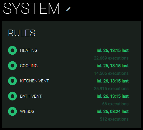

Here is the start of a DSL rule used for my kitchen ventilation
rule "Kitchen ventilation control"
    Item rule_kitchenVentilation changed
    or
    Time cron "/30 * * * * ?"
    or
    Item VentilationMode_Kitchen changed
	if (rule_kitchenVentilation.state == ON) {
		postUpdate(rule_kitchenVentilation_TimeStamp, new DateTimeType())
		var Number counter
		counter = rule_kitchenVentilation_Counter.state as DecimalType
		counter = counter + 1
		postUpdate(rule_kitchenVentilation_Counter,counter)
//    your code after this line
rule_kitchenVentilation - turns the rule execution on/ off
rule_kitchenVentilation_Counter - counts how many times the rule was triggered
rule_kitchenVentilation_TimeStamp - shows the last time the rule was executed
And here is a print screen from habpanel
