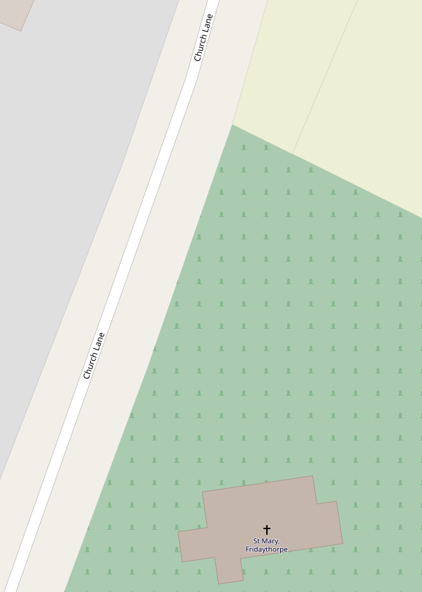

Or you can use OpenStreetMap directly in a Frame widget with a pin like this —
https://www.openstreetmap.org/?mlat=54.02227&mlon=-0.66649#map=19/54.02227/-0.66649
Changing the number after map= sets the zoom level.
You can download an image if you prefer
