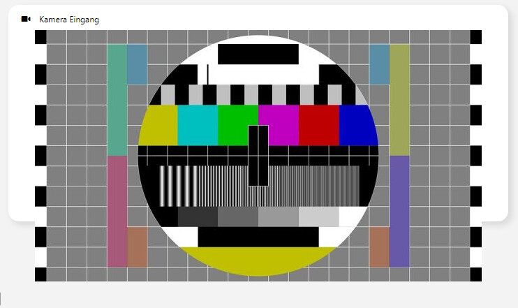

This is the result:
ok
But using one of the ipcamera URLs like in the following example doesn’t work. Screenshot of the broken image below:
