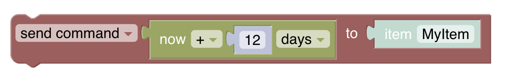

Why not use both? You can leave your existing rules in DSL and start new ones in Blockly. Then you can decide later if you want to completely shift over or just leave things as they are.
I wouldn’t say you’re overcomplicating. Your focus was on “how do I start a rule at the right time”. Expiring an item enabled you to do just that. Anything else really is more complicated.
When you have a particular perspective, it’s very easy to get stuck on other solutions needing to fit into the same perspective. Looking at it from an outside perspective, it was easy for me to shift your logic from “start the rule at the right time” to “run the code inside of the rule at the right time”. And that was only easy because I’ve gone down this exact same route myself. We all do it…and not just with openHAB rules.
