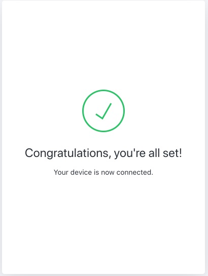

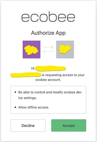

After you enter the XXXX-XXXX PIN, you should see this.
Followed by this.
Followed by this.

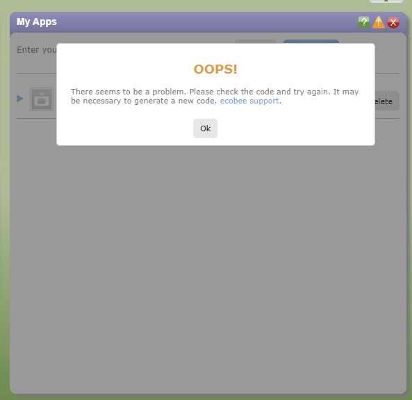

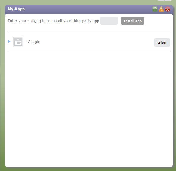

I don’t see anything like that. BTW, I have one of the original smart thermostats. This is the My Apps panel:

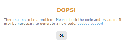

Then I get this when I enter the pin and press the “Install App” button:
Hmm. What app is that that you’re using?
