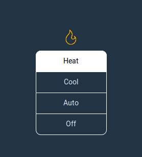

Heat only
Menu to change heating mode

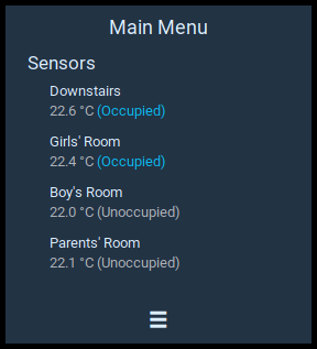

Remote Sensor display
Change log
  • Fixed bug that would display sensors incorrectly if displayed on main page
  • Fixed bug that would display sensors out of order or not at all

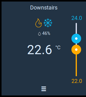

For some reason when I change the temp slider, it does not change my actual thermostat temperature. I can change it from Heat to Cool and back again without issue (i.e. it changes the thermostat). Temperature slider does nothing. Any ideas?
My first guess would be that the rules file isn’t correctly installed?
Make sure you updated your ecobee id in that file and it’s in the right place.
If it looks ok, i’d say take a look at the event logs and see if the items are being updated.

It doesn’t seem to read all my remote sensors correctly… no events in the log file and nothing obvious… thoughts?
It shows 2 out of the 4 total as follows:
Living Room
20C (Unoccupied)
(Unoccupied)
Home
20.2C (Unoccupied)
(Unoccupied)
Fixed and updated. Try again
Just updated… same problem… actually, now I only see one name (Living Room) and the rest are no names, no temperatures, and all state (unoccupied).
Also, now I have the A in front of my degrees Celsius reading.

Celsius fixed, but now there are no names for any of the Sensors… I’ve got temperatures and occupancy for all 4. Just no names.
Appreciate the quick turn around on these!
Ahh, ok I see the issue, will try an update but can’t today
stay tuned.
I pushed an update, please try again
All working. Awesome work and thank you!
