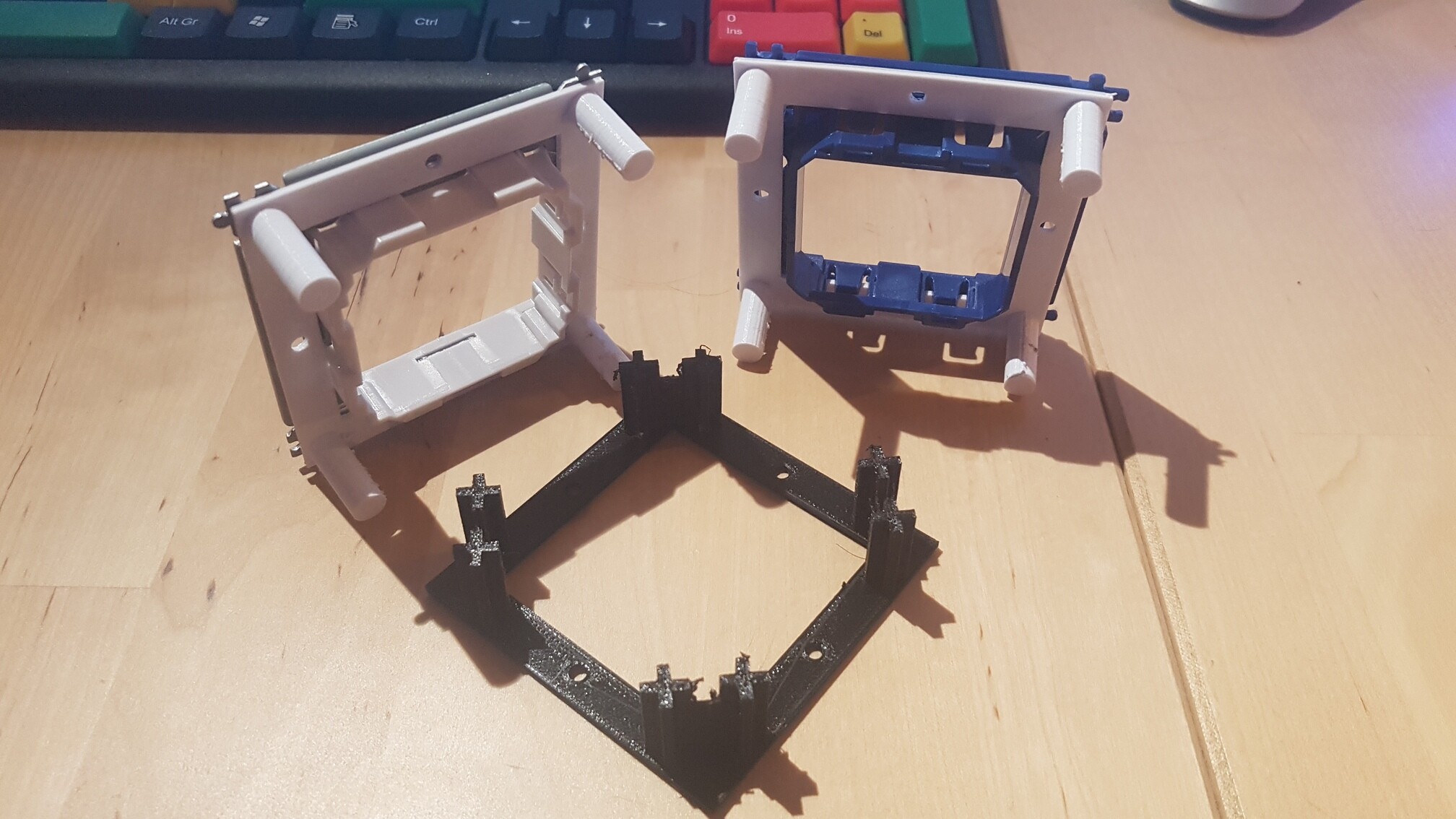

I’ve purchased a 3D printer and come up with a better way of supporting the Blue frames in UK boxes, by effectively giving them support from the base of the box.
These are a work in progress, but easy enough to adapt for different back box designs,
How about doing something for the LK Fuga (stupid danish micro-design) wall boxes :smiley:
