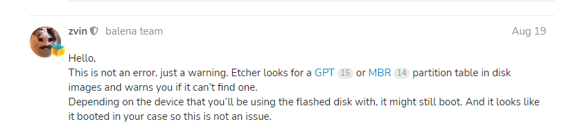

Is the message on etcher just a warning as described here: Missing Partition Table Issue - balenaEtcher - balenaForums
What happens if you click on continue? Does etcher do the flashing? Above you’ve reported that you don’t have a problem with the continue button.

RasPI boots different than other devices (see https://www.raspberrypi.org/documentation/configuration/boot_folder.md)
So instead of looking for a MBR or GPT, Raspi looks onto the first partition of the attched SD for the relevant files and starts booting. So ignore the warning and continue
