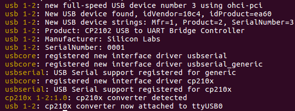

The USB Adapter is cross-platform.
It uses the CP2102 USB → UART converter, which was described before in this thread and used by Telegesis stick as well.
Yes, on Windows you might need to install drivers additionally. But this is described both in this thread and for example here: How to Install Drivers on Windows
