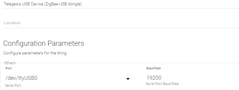

why does the baud rate resets after reboot of the OS. (from 57600 to standard 19200 in paper ui)
also it resets after scan of zigbee binding.
is this a bug?
It shouldn’t do this. I know others (using Ember dongle for example) can change the baud rate without problem (there are two different Ember versions, and they use different baud rate and different flow control), so I don’t see why the Telegesis dongle should be any different as it’s literally exactly the same code (ie it uses a common class for all dongle types).
I just did a quick test using the Ember dongle, and it definitely saves the baud rate…

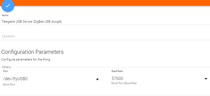

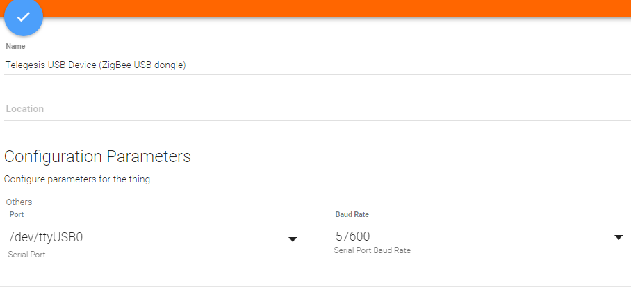

i set my baud rate to 57600. → save the edit → paper ui says ONLINE → after reboot of raspberry the config resets to 19200.
here some screenshots

so i have to manually change to baud rate to 57600 in the paper ui config everytime i restart the raspberry.
I’m not sure why the reset of the PI would make any difference. When you save the speed, the binding saves this information, and then restarts the handler. This then reads it out of the system storage where all this stuff is stored (probably the json db unless you have something else configured).
So the information is stored or you wouldn’t be able to change the baud rate at all. Why a PI restart should affect that I have no idea, but it’s probably not related to the binding. Do other config also change?
I can test this with a Telegesis stick as well, but since all dongles use the same base class, it must be the same.
