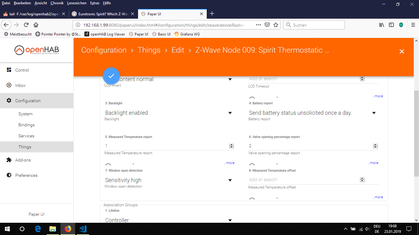

As you operate the Spirit successfully: Would you mind to send me your item definition and maybe a screenshot of the configuration page? Thanks in advance!
No problem, following my .items file:
Number ThermostatSollBuero "HK Büro Solltemp [%.1f °C]" {channel="zwave:device:Razberry2:node9:thermostat_setpoint_heating"}
Number ThermostatSollAbsenkungBuero "HK Büro TempAbsenkung [%.1f °C]" {channel="zwave:device:Razberry2:node9:thermostat_setpoint_heating_econ"}
Number BatterieSpiritBuero "Batterie HK BĂĽro [%.1f %%]" {channel="zwave:device:Razberry2:node9:battery-level"}
Number TemperaturIstBuero "HK Büro Isttemp [%.1f °C]" {channel="zwave:device:Razberry2:node9:sensor_temperature"}
Number HeizmodusBuero "HK BĂĽro Modus" {channel="zwave:device:Razberry2:node9:thermostat_mode"}
Dimmer VentilstellungBuero "HK BĂĽro Ventilstellung [%d %%]" {channel="zwave:device:Razberry2:node9:switch_dimmer"}
And config from Paper UI:
grafik
Great, thanks :smiley:
Any settings below the lifeline setting that I should know?
No, there are just polling period 1 day and command poll period 1500 which I did not change.
Good luck!
