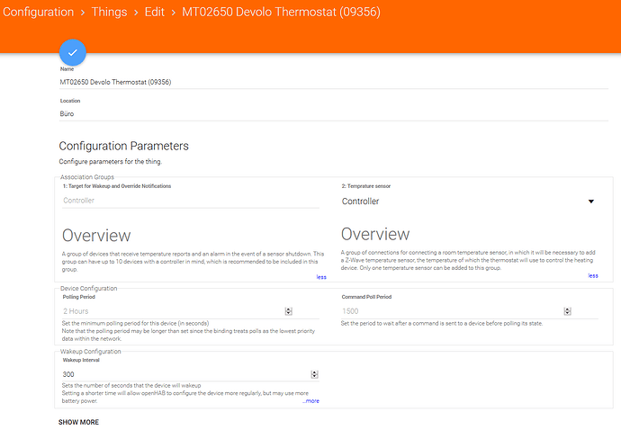

Here are my current settings:

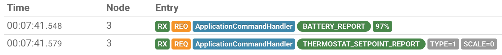

Here some logs in Z-Wave TRACE mode. I now set the setpoint value to 15°C:

2019-01-20 00:07:41.539 [TRACE] [WaveSerialHandler$ZWaveReceiveThread] - Received SOF
2019-01-20 00:07:41.548 [DEBUG] [WaveSerialHandler$ZWaveReceiveThread] - Receive Message = 01 09 00 04 00 03 03 80 03 61 10
2019-01-20 00:07:41.563 [TRACE] [WaveSerialHandler$ZWaveReceiveThread] - Message is valid, sending ACK
2019-01-20 00:07:41.567 [TRACE] [WaveSerialHandler$ZWaveReceiveThread] - Response SENT 6
2019-01-20 00:07:41.570 [DEBUG] [nal.protocol.ZWaveTransactionManager] - processReceiveMessage input 0<>128 : Message: class=ApplicationCommandHandler[4], type=Request[0], dest=3, callback=0, payload=00 03 03 80 03 61
2019-01-20 00:07:41.574 [TRACE] [WaveSerialHandler$ZWaveReceiveThread] - Received SOF
2019-01-20 00:07:41.574 [DEBUG] [nal.protocol.ZWaveTransactionManager] - Received msg (0): Message: class=ApplicationCommandHandler[4], type=Request[0], dest=3, callback=0, payload=00 03 03 80 03 61
2019-01-20 00:07:41.577 [DEBUG] [nal.protocol.ZWaveTransactionManager] - lastTransaction null
2019-01-20 00:07:41.579 [DEBUG] [WaveSerialHandler$ZWaveReceiveThread] - Receive Message = 01 0C 00 04 00 03 06 43 03 01 42 04 B0 45
2019-01-20 00:07:41.580 [DEBUG] [nal.protocol.ZWaveTransactionManager] - NODE 3: Application Command Request (ALIVE:DONE)
2019-01-20 00:07:41.582 [DEBUG] [ng.zwave.internal.protocol.ZWaveNode] - NODE 3: resetResendCount initComplete=true isDead=false
2019-01-20 00:07:41.585 [DEBUG] [ng.zwave.internal.protocol.ZWaveNode] - NODE 3: Incoming command class COMMAND_CLASS_BATTERY, endpoint 0
2019-01-20 00:07:41.588 [DEBUG] [ng.zwave.internal.protocol.ZWaveNode] - NODE 3: SECURITY not supported
2019-01-20 00:07:41.591 [DEBUG] [tocol.commandclass.ZWaveCommandClass] - NODE 3: Received COMMAND_CLASS_BATTERY V1 BATTERY_REPORT
2019-01-20 00:07:41.594 [DEBUG] [ommandclass.ZWaveBatteryCommandClass] - NODE 3: Battery report value = 97
2019-01-20 00:07:41.596 [TRACE] [WaveSerialHandler$ZWaveReceiveThread] - Message is valid, sending ACK
2019-01-20 00:07:41.596 [TRACE] [ve.internal.protocol.ZWaveController] - Notifying event listeners: ZWaveCommandClassValueEvent
2019-01-20 00:07:41.600 [TRACE] [WaveSerialHandler$ZWaveReceiveThread] - Response SENT 6
2019-01-20 00:07:41.599 [DEBUG] [ding.zwave.handler.ZWaveThingHandler] - NODE 3: Got an event from Z-Wave network: ZWaveCommandClassValueEvent
2019-01-20 00:07:41.602 [DEBUG] [ding.zwave.handler.ZWaveThingHandler] - NODE 3: Got a value event from Z-Wave network, endpoint = 0, command class = COMMAND_CLASS_BATTERY, value = 97
2019-01-20 00:07:41.604 [DEBUG] [nal.protocol.ZWaveTransactionManager] - processReceiveMessage input 0<>128 : Message: class=ApplicationCommandHandler[4], type=Request[0], dest=3, callback=0, payload=00 03 06 43 03 01 42 04 B0
2019-01-20 00:07:41.606 [DEBUG] [ding.zwave.handler.ZWaveThingHandler] - NODE 3: Updating channel state zwave:device:512:node3:battery-level to 97 [DecimalType]
2019-01-20 00:07:41.608 [TRACE] [WaveSerialHandler$ZWaveReceiveThread] - Received SOF
2019-01-20 00:07:41.610 [DEBUG] [nal.protocol.ZWaveTransactionManager] - NODE 3: Commands processed 1.
2019-01-20 00:07:41.614 [DEBUG] [nal.protocol.ZWaveTransactionManager] - NODE 3: Checking command org.openhab.binding.zwave.internal.protocol.ZWaveCommandClassPayload@94d48c.
2019-01-20 00:07:41.617 [DEBUG] [nal.protocol.ZWaveTransactionManager] - Transaction completed - outstandingTransactions 0
2019-01-20 00:07:41.620 [DEBUG] [nal.protocol.ZWaveTransactionManager] - Transaction completed - outstandingTransactions 0
2019-01-20 00:07:41.623 [DEBUG] [WaveSerialHandler$ZWaveReceiveThread] - Receive Message = 01 0A 00 04 00 03 04 46 08 00 7F C7
2019-01-20 00:07:41.623 [DEBUG] [nal.protocol.ZWaveTransactionManager] - Received msg (0): Message: class=ApplicationCommandHandler[4], type=Request[0], dest=3, callback=0, payload=00 03 06 43 03 01 42 04 B0
2019-01-20 00:07:41.625 [DEBUG] [nal.protocol.ZWaveTransactionManager] - lastTransaction null
2019-01-20 00:07:41.628 [DEBUG] [nal.protocol.ZWaveTransactionManager] - NODE 3: Application Command Request (ALIVE:DONE)
2019-01-20 00:07:41.631 [DEBUG] [ng.zwave.internal.protocol.ZWaveNode] - NODE 3: resetResendCount initComplete=true isDead=false
2019-01-20 00:07:41.633 [DEBUG] [ng.zwave.internal.protocol.ZWaveNode] - NODE 3: Incoming command class COMMAND_CLASS_THERMOSTAT_SETPOINT, endpoint 0
2019-01-20 00:07:41.636 [DEBUG] [ng.zwave.internal.protocol.ZWaveNode] - NODE 3: SECURITY not supported
2019-01-20 00:07:41.639 [DEBUG] [tocol.commandclass.ZWaveCommandClass] - NODE 3: Received COMMAND_CLASS_THERMOSTAT_SETPOINT V1 THERMOSTAT_SETPOINT_REPORT
2019-01-20 00:07:41.640 [TRACE] [WaveSerialHandler$ZWaveReceiveThread] - Message is valid, sending ACK
2019-01-20 00:07:41.642 [DEBUG] [.ZWaveThermostatSetpointCommandClass] - NODE 3: Thermostat Setpoint report Scale = 0
2019-01-20 00:07:41.644 [TRACE] [WaveSerialHandler$ZWaveReceiveThread] - Response SENT 6
2019-01-20 00:07:41.645 [DEBUG] [.ZWaveThermostatSetpointCommandClass] - NODE 3: Thermostat Setpoint Value = 12
2019-01-20 00:07:41.647 [DEBUG] [.ZWaveThermostatSetpointCommandClass] - NODE 3: Thermostat Setpoint Report, Type Heating (1), value = 12

2019-01-20 00:07:41.832 [TRACE] [nal.protocol.ZWaveTransactionManager] - NODE 3: Node not awake!
2019-01-20 00:07:41.835 [TRACE] [ng.zwave.internal.protocol.ZWaveNode] - NODE 3: listening == false, frequentlyListening == false, awake == false
2019-01-20 00:07:41.836 [TRACE] [nal.protocol.ZWaveTransactionManager] - NODE 3: Node not awake!
2019-01-20 00:07:41.839 [TRACE] [ng.zwave.internal.protocol.ZWaveNode] - NODE 3: listening == false, frequentlyListening == false, awake == false
2019-01-20 00:07:41.840 [TRACE] [nal.protocol.ZWaveTransactionManager] - NODE 3: Node not awake!
2019-01-20 00:07:41.843 [TRACE] [ng.zwave.internal.protocol.ZWaveNode] - NODE 3: listening == false, frequentlyListening == false, awake == false
2019-01-20 00:07:41.844 [TRACE] [nal.protocol.ZWaveTransactionManager] - NODE 3: Node not awake!
2019-01-20 00:07:41.847 [TRACE] [ng.zwave.internal.protocol.ZWaveNode] - NODE 3: listening == false, frequentlyListening == false, awake == false
2019-01-20 00:07:41.848 [TRACE] [nal.protocol.ZWaveTransactionManager] - NODE 3: Node not awake!
2019-01-20 00:07:41.851 [TRACE] [ng.zwave.internal.protocol.ZWaveNode] - NODE 3: listening == false, frequentlyListening == false, awake == false
2019-01-20 00:07:41.852 [TRACE] [nal.protocol.ZWaveTransactionManager] - NODE 3: Node not awake!
2019-01-20 00:07:41.855 [TRACE] [ng.zwave.internal.protocol.ZWaveNode] - NODE 3: listening == false, frequentlyListening == false, awake == false
2019-01-20 00:07:41.856 [TRACE] [nal.protocol.ZWaveTransactionManager] - NODE 3: Node not awake!
2019-01-20 00:07:41.858 [TRACE] [nal.protocol.ZWaveTransactionManager] - Transaction SendNextMessage nothing

I don’t see anything wrong here. The device has not woken up, so there will be no data transferred.
These devices sleep nearly all the time. They only wake up for short periods, and it’s only during these short periods that setpoint changes can be transferred.
Please wake up the device and provide another log. Please also do not use TRACE level logging unless asked for it as it just adds a lot of extra logging that is nearly always unnecessary.

I think I’ve been through this, but let me repeat how battery devices work…
ZWave battery devices sleep most of the time. They only wake up periodically - normally around every hour, but it depends on how the wakeup period is set. The binding can only communicate with the device when the device wakes up. In the log you sent, the device did not wake up.
The fact that the device sent its current temperature is completely irrelevant - that is the device communicating with the binding - the opposite way around is not possible unless the device wakes up!
From the log above, there is no wakeup -:
You need to wake up the device - I hope tat makes sense.
Your 4 °C are likely still in the queue waiting for a wakeup of the device.
You could reduce the wakeup time… to set the temp faster … BUT this SIGNIFICANTLY reduces battery.

I once had a device set to 4min wakeup time… reducing battery from about 2 years to 2 weeks…
so anything below one hour should be nonsense…
if you need to set setpoints quick … like window opens .. setpoint 4 °C … you MUST use a different device with flirs
Okay, so I will try to change the device. I will open a new thread to get a recommendation, okay?
as chris mentioned above.
there is only a single thermostat device which supports flirs currently
the eurotronic spirit. so no choices … sorry.
additonally if you want to stick with your current device at least cron job use cases are feasible.
  1. set wake up to something reasonable (60-90 min)
  2. e.g. 2 cron jobs 8am - 20pm = 21 °C … 20pm - 8am = 18 °C
something like this would work with the devolo. in worst case e.g. your 18 °C would be 60-90 mins later …
for anything else ..> spirit
