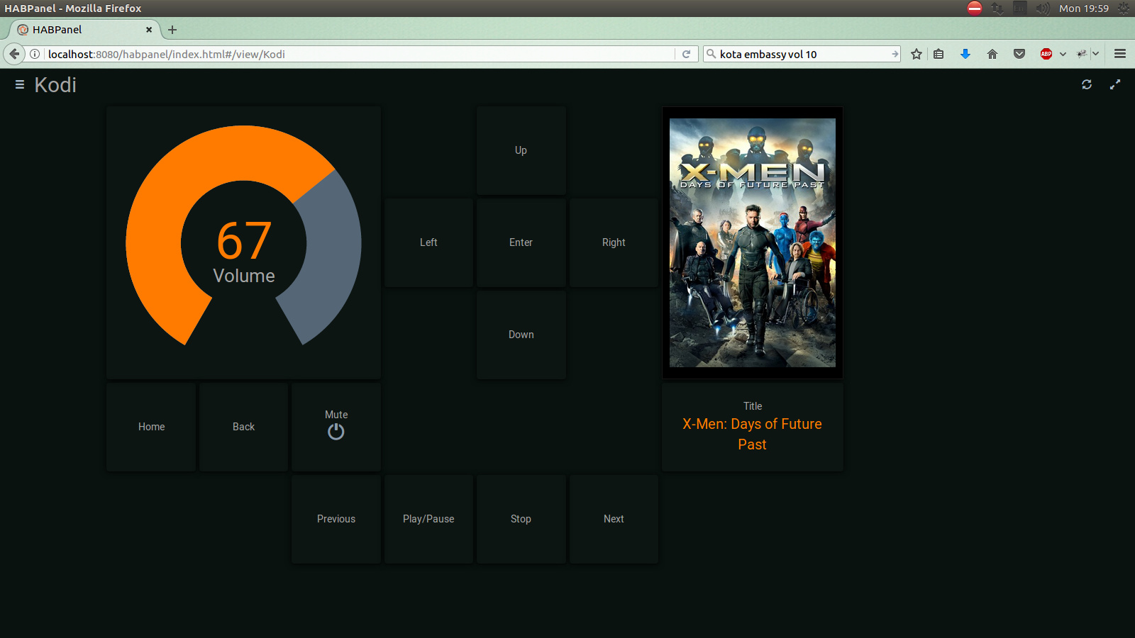

Hey Again
This is what I’ve done so far…
I just wanted to ask if anyone has done a satusbar for Kodi on the Habpanel…
And also for the buttons I wanted to add icons, I am familier with HTML and CSS, but what I wanted to do is to get the stock functions from the habpanel itself rather then rendering a mini page that displays a picture and sends a command

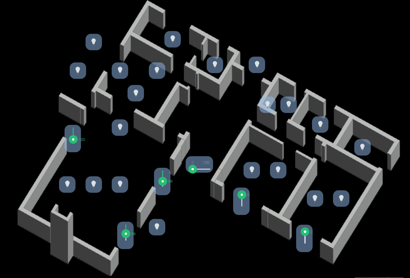

I also played a little bit around…
At the moment it is only a demo (and by the way that’s not my house)!
So that’s the result of my experiment (based @Dim #s exapmle and @ysc 's example and iconset):

Sorry for the delay!
I’ll give you a brief descritpion based on the garage button in the template of the housefront in the upper left corner.
  1. create a new dashboard
  2. add a new template, resize and positioning it on the dashboard
  3. edit the template
  4. check on “No background”
  5. insert the following div element for the background image:
<div style="position:absolute;
    top: 0px;	bottom: 0px; left: 0px; right: 0px;
		background: url('/static/image/housefront.jpg');
		background-size:cover;
		background-repeat: no-repeat;">
(the background image “housefront.jpg” has to be stored in your opanhab conf folder under html/image)
  1. now you have to insert a div for the button:
 <div ng-init='HF_Garage_1={"name": "HF_Garage_1", "item": "HF_Garage_1", "hidelabel": true, "hideonoff": true, "iconset": "smarthome-set", "icon": "garage" }'>
		<widget-switch size="32"
		style="position: absolute;
		background: rgba(147,189,238,0.5);
		border-radius: 10px;
		top: 240px; left: 220px;
		width: 50px; height: 50px"
    ng-model="HF_Garage_1"
</div>
  1. The difficult is to positioning the button on the background image. Because there is no WYSIWYG editor you have to play around with the parameters “top” and “left” by increasing or decreasing them, run the dashboard and control the position of the button on the dashboard … I promise you that will be a lot of try and error.
  2. repeat step 6 and 7 for each button you want to have
  3. and repeat the steps 2 to 6 for each room you want to have on the dashboard

widget code...needs cleanup but works. Big thanx to @ysc !
