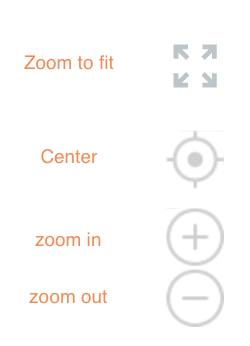

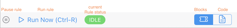

I provided another enhancement for blockly: From now on, you can zoom the Blockly Workspace:
You can find this in the bottom right corner. This also allows pinching on touch screens or touch pads.
Not to conflict with the “old” Code-Button, this was “moved” into a new version into the footer of the workspace (Kudos to @ysc):

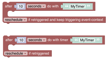

I have a generic Blockly script that runs when a light group is triggered by a motion sensor. It then waits a certain amount of time to turn off the light or in the case of a retrigger of the motion sensor keep the lights on. I’ve tried to do this with the timers available in the OpenHAB section but that doesn’t work properly as timers (or probably the event context) is lost when a different light group is triggered.
I’m now using the common blocks from this community marketplace post: Collection of common blocks. Basically the timer block that keeps the triggering event context. That block actually works great and allows me to create the desired automation.
Is it possible to include the common blocks (or at least the specific timer one that keeps the event context) into the main OpenHAB section? It’s to avoid that I’m dependent on an ‘external’ block instead of what is available in OpenHAB out of the box. Thanks for considering!
As @rlkoshak is our genie on timers I loop him in here:
Rich, the first block is the one that Marco mentions, the second is ours
The code difference is minimal
if (typeof this.timers['MyTimer'] === 'undefined' || this.timers['MyTimer'].hasTerminated()) {
  this.timers['MyTimer'] = scriptExecution.createTimerWithArgument(zdt.now().plusSeconds(10),event, function (event) {
} else {
  this.timers['MyTimer'].reschedule(zdt.now().plusSeconds(10));
  this.timers['MyTimer'] = scriptExecution.createTimer(zdt.now().plusSeconds(10), function () {
} else {
The only difference is that it uses
  • createTimerWithArgument
  • add the event-variable as an additional parameter and forwards it to the function
Could we not just do that in general?
If not, we could give the timer-blocks an additional choice to choose from but I need to check of that would be backward compatible, so it doesn’t break old blocks.
What do you think?
There are subtitles involved here that probably needs to be explored before deciding how to proceed. The big concern is that
  1. sometimes you want to have the event and possibly other stuff as it was when the timer was created
  2. other times you want to have the event and other stuff as it is right now, possibly having been changed since the timer was created on a subsequent rule trigger.
The difference is subtle but important. Ideally both use cases should be supported. I personally prefer using function generators because it lets you “fix” multiple variables rather than just the one variable. For example:
var timerGenerator = (one, two) => {
  return function() {
    // function called by the timer which uses arguments one and two somehow
scriptExecution.createTimer(zdt.now().plusSeconds(10), timerGenerator(event, foo));
We call a function passing the arguments and get back a function that will get called by the timer. The passed in arguments become fixed and won’t be overridden when the rule runs again. But that’s a pretty big lift for the typical blockly user (though I think it should be possible).
I think maybe splitting the difference would be be better. Rather than forcing the argument passed to the timer to be the event, why not let us pass our own argument, including event? But I think that would involve creating a new “timer with argument” block where one can select the event or any other variable defined.

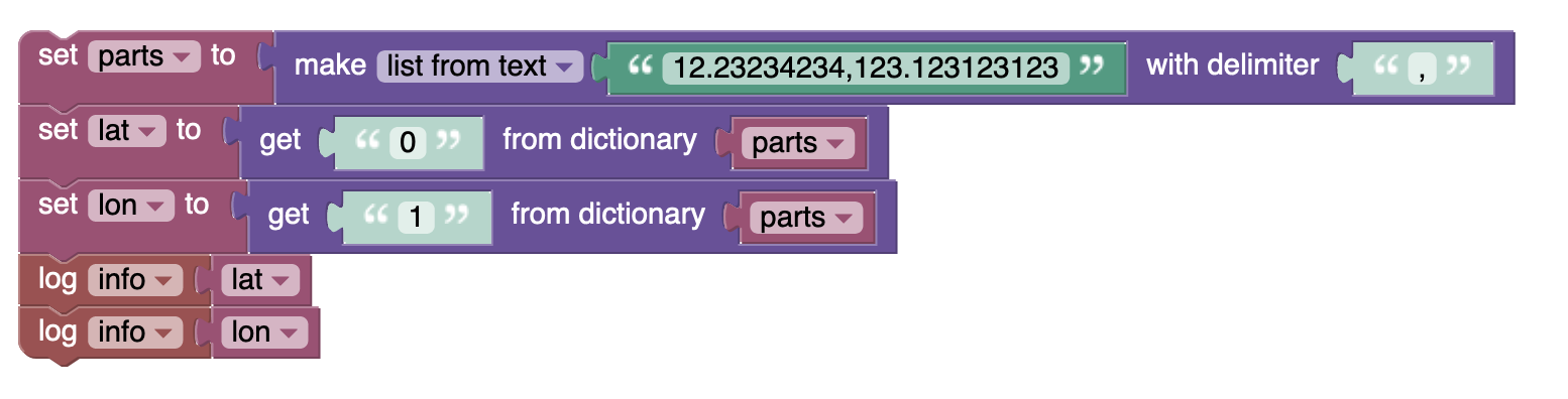

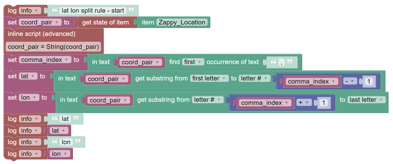

Hello Stefan
this is the example of trying to use the “state” of a location item, as a string, to split off the latitude and longitude for further use.
edit; i guess the reason for not being able to treat the state of the location item as a string is that it is returned as an object
Hey @joriskofman
I also love blockly… here a much smaller code. You can create a list from the location item and access directly the first (0) and second (1) item:

Good one @timl your code also works if there would be an elevation field in the location item, mine would break

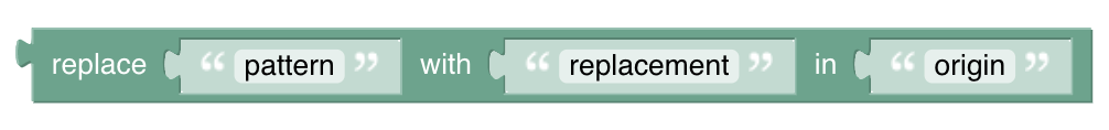

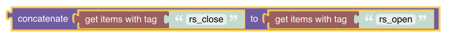

These are the blocks that will be available soon:
oh_text_replace: a new text replace block that is missing in the standard text block section
oh_taggeditems: retrieve a list of items identified by one or multiple tags
oh_list_concatenate: allows to concatenate two lists into a new lists
oh_get_persistvalue: add new previousState (new mutating block)
oh_zdt_fromText: add time support

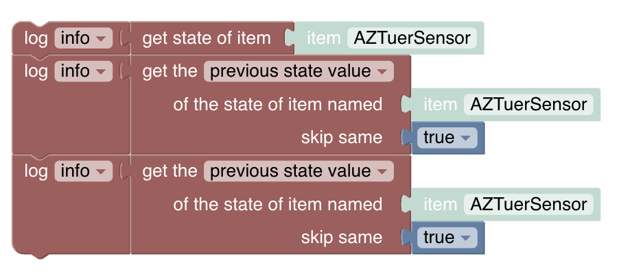

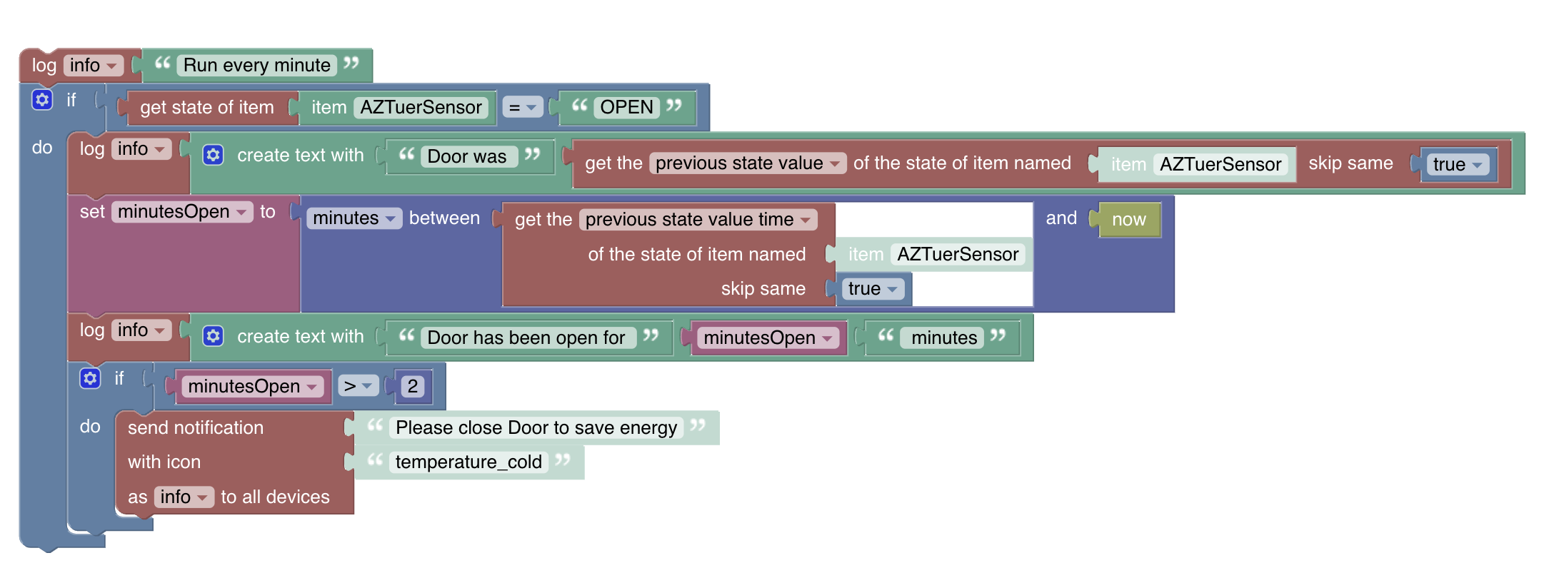

I added some more functionality to allow skipping the same state until it finds a different one to the current state:
This for example allows to find out how long a door has been kept open and if it exceeds a certain time, a notification is sent to the user to close it
You can even go further and use the tag block to gather ALL windows that are tagged with OpenState by running this rule once a minute:
Note: to be able to use the skip=true, rrd4j isn’t sufficient as it does not support skipping. You may add influxdb for that purpose and set the default persistence to that.

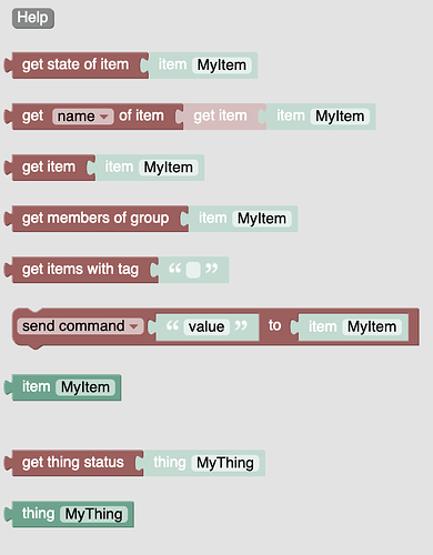

I’d like to have your opinion on the following topic.
Since we have introduced our blocks it more and more became clear to me that the naming of the word “item” in the blocks is actually not really consistent and it can lead to the wrong usage of the blocks
note that I just yesterday implemented some more rigid type checking on these which was actually flawed over the past months but still type checking can be “circumvented” when introducing variables (type checking is then not applied).

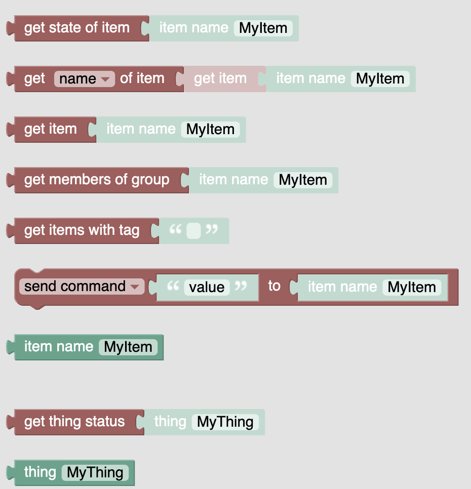

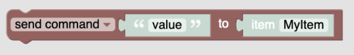

So what is the problem - let’s have a look at these blocks:
This here is actually not an item but only an item name that is picked by the user - it is essentially a string
This will return an item object
This doesn’t send a command to an item but to an item name to be precise

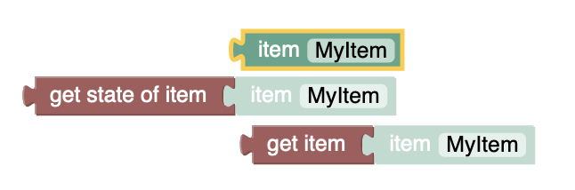

Again, in 4.0 I have implemented checks, that make sure that the blocks cannot be attached to the wrong place (that is still possible in 3.4) but with vars it can be pretty confusing and to be honest I myself fell intro that trap:
Looks right, doesn’t it?

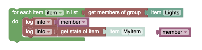

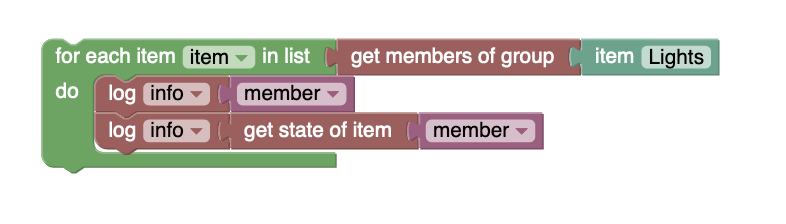

Unfortunately it isn’t and it crashes. Let me show why:
“get state of item” expects an item-name and not an item which the variable actually contains.
Here are proposals
  1. It isn’t that big of an issue and we just have to document it well enough
  2. We rename the green item to become more precise
which then would become the following for all the other blocks (which might be a bit lengthy)
  1. We could try to detect in jsscripting (graalvm) if a name or an item object is given and therefore become more forgiving and resilient. However, that doesn’t improve the current implementation based on Nashorn.
So what’s your vote or do we have an option 4?

  1. If even you fell into this trap I’m certain it will become a significant issue among others.
  2. I like this as the bare minimum thing to do. One of the strengths of Blockly is it’s self describing. Being explicit here helps with that.
But, what happens if you have the following?
get state of item -> get item -> item name [MyItem]
Does get state of item only support the Item name or can I also pass it the Item Object?
Could it make sense that we only have a get item and adjust the other blocks to always expect an Item Object?
Or the converse, always expect an Item name and the other blocks adjusted to convert to an Item Object?
I’m nervous about both ideas, especially when you start working with Group members.
And this begs the question, why do we have both get state of item and item name in addition to get x of item (which presumably can get both the state and Item name)? Is it because we get the name and state so often that we created a separate block for convenience or is there a deeper reason?
  1. Why would this be limited to graalvm? It seems possible to do with Nashorn too. I like this idea but it will make the underlying code a tiny bit more complicated.
  2. Ignoring the chaos and breaking changes, what if we did away with item name and instead we get the Item Object in that block? Adjust the other blocks to always want an Item Object instead of just the name. We’d need to keep the get item block for cases where an Item’s name is constructed in the code of course.
There’s a third option, change to use LocalDateTime. I’m not pushing that, just mentioning that it could be an option.

That was one thing that caused the trouble because you were able to stick to it but it lead to broken code that crashed. Since yesterday it is now typed. Get-State-of-Item requires an item-Object which itself requires an item-picker that returns the name.
Why did that happen?
The green item was on of there very first blocks that existed which does not return an item-object but just the name - it is the item name picker to be correct. That couldn’t be changed because it would have broken 80% of all rules that existed.
No, at least it doesn’t now. As I mentioned it broke the code. I could look into it if that was possible and I will put that on my list but still it doesn’t solve the name problem of the block. It is not clear if “item” on a blocks’s name refer to the item or only the name.
Most likely it will break many rules, so I very much doubt that. And just to bring that up before someone comes up with that idea :wink: : Migration of blocks to me is out of the question (at least as far my capacity of work is concerned unless someone steps up for it)
Again, similar to the proposal above, we cannot get rid of the other blocks as well because it would break rules that would is. I am not saying that we might be able to provide the possibility to stock a light item (aka the name) or a real item (object) into some other block and it is intelligent enough to know what it needs. I just don’t if we have enough test examples that we can make sure we cover all permutations. Let me put it that way, if someone would think through all examples we can do now with all blocks that stick together or use items with these combinations then I would start thinking about (don’t perceive this as a veto) designing because again, we must make 100% we do not break anything (even I have more 100 blockly rules which I don’t like to update, btw).
:100:
Yes, that was surely the reason. AFAIK, getState was one of the very first blocks that was provided (remember the times when we only had a handful of blocks :wink: ). And to be honest, it really makes sense. It is the item attribute that even I use in 90% of my rules.
I don’t mind doing backporting things to Nashorn (as long as it doesn’t break anything) and don’t worry too much about these two: the code that generates both ways are still pretty similar and it is still easy to maintain both which I am pretty happy about. So, no, that isn’t an issue.
As I said I would veto breaking anything because we would scare away our beloved blockly users right away.
I am happy to add or improve things and even provide some new features only to GraalVM but not break the old rules. For example the new rules for handling Units of Measurement will only be support with GraalVM and I am sure that is a good incentive to move over but the move is nothing but selecting the new script language and everything will be done in the background (note that moving back could break rules in case you use newer blocks)
