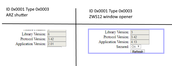

manuf
And the manual says it’s a Z-Wave Plus device.
Have you tried emailing the manufacturer with your device type:id to ask them for the specs for the device?
You’re right. It appears that there are a number of ARZ roller shutter variants, the old ones being Z-Wave and a newer one being Z-Wave Plus. Ours are definitely not Z-Wave Plus.
No, I haven’t. However I found an online copy of the manual that was shipped with our roller shutters here - it’s from 2013 whereas the other manual is from 2017.
So:
  1. The ‘old’ Z-Wave version (v1.0) of the ARZ roller shutters looks like this - reports as 0085:0002:0002
  2. The ‘intermediate’ Z-Wave version (v2.1 if inferred from applicationVersion) we have at home (info not found on the Z-Wave Alliance portal) - reports as 0085:0003:0001
  3. The ‘new’ Z-Wave Plus version of the ARZ roller shutters looks like this - reports as 0085:0003:0011

From this overview, I would infer that 0085:0003:0001 was incorrectly assigned to the window winder category (products with Device Type 0002)…
It’s not clear to me how you infer this from this table?
The category is really not so relevant - it’s only used in OH to show an icon. The bigger issue is how the device identifies in the ZWave database.
Unfortunately, it’s hard to know what everyone else uses and I’m always hesitant to change IDs. Generally, someone added the device, and presumably it was tested and their system works. If someone else thinks it’s wrong, and changes it, then we get into a mess.
It would be good if others with these devices can comment on what they have, and what the device ID/Type are so we can build a table with this information.
Alternatively, if the manufacturer can supply this it would be the best option. Manuals and the ZWave Alliance database tend to be very poor at documenting this information - the ZWA database is generally very incomplete.
Apparently Fakro window winders are listed as having a Device Type 0x0002, and external roller shutters are listed as having a Device Type 0x0003. There are 2 exceptions: 0002:0002 (ARZ roller shutter) and 0003:0001 (the problematic “double” item: ARZ Roller shutter AND ZWS12 window winder).
I agree that it’s difficult to change something in the device database once it’s been added, as it relies on authentic profiles being submitted. For what it’s worth, the same problem occurs with OZW (also reported as ZWS12 Chain actuator 12VDC:

I have 3 ARZ devices and 3 ZWS devices. Those devices identify themselves as:
ARZ Shutters
ID 0x0001 Type 0x0003 - Fakro ZWS12 Chain actuator 12VDC
ID 0x0002 Type 0x0002 - Fakro ARZ Roof Window Roller Shutter
ZWS12 Windows Openers:
ID 0x0001 Type 0x0002 - Fakro Unknown: type=0002, id=0001
What you can see is that I have both an ZWS12 as well an ARZ, both identifying themselves as ID 0x0001 Type 0x0003.
Probably Fakro made a mistake in their firmware. How to tell them about this error, and convince them. I already tried to mail them about this issue in 2018, but without any responds. They simply ignored my email about this.
Now I’m reading more people are having trouble with ARZ devices recognized as ZWS12.
Because it is an Fakro mistake, this can not be solved in OZW, openhab, domoticz, home assistant or whatever. Users of those devices need a software update, or a new device covered under fakro warranty, because it is an production failure.
Thanks for your input on the matter!
It would be great if we could find a way to distinguish the ZWS12 chain actuator from the ARZ roller shutter. I was hoping that they would be using different firmware versions. Can you check if they state the same or different firmware versions?
I sent an email to Fakro about this problem, for the second time, and this time I received an answer:
Beste heer van Benthum,
Een aantal jaar geleden zijn er inderdaad problemen ontdekt met de identificatie van een aantal producten, op basis daarvan zijn er wijzigingen doorgevoerd (november 2016) en zouden de producten onderstaande identificatie moeten bezitten:
ARZ Z-Wave: TYPE: 0x0003, ID 0x0001
ZWS12: TYPE: 0x0002, ID 0x0001
Indien uw producten dit niet bezitten en dit voor u een probleem vormt met de configuratie hiervan of anderszins dan kunnen de drivers van de producten een update krijgen.
De update kan echter alleen door de serviceafdeling op onze fabriek worden uitgevoerd en dit houdt in dat de producten hier dan retour naar moeten.
Indien u hiervan gebruik wilt maken verneem ik het graag, en ontvangen wij vervolgens de producten graag hier bij ons in Nederland, zodat wij kunnen zorgen dat de update wordt uitgevoerd en u de producten weer ontvangt.
Alvast bedankt.
Luc Bonnet | Technisch adviseur
luc@fakronederland.nl
They tell there was indeed an error, they discovered in 2016, en changed the device identification numbers from 2016.
It means that ZWS12: TYPE: 0x0003, ID 0x0001 is the wrong combination. Every ZWS12 showing up with 0x0003, ID 0x0001 is wrong. Fakro tells it can update the device software, but therefore the module needs to be returned to Fakro.
To solve the trouble with the duplicated in the open z-wave database, the ZWS12 with TYPE 0x0003, ID 0x0001 should be removed, and only ARZ Z-Wave: TYPE: 0x0003, ID 0x0001 can exist.
People with faulty ZWS12 should contact Fakro to solve the problem, if the have trouble with operating the device properly.
Bram
