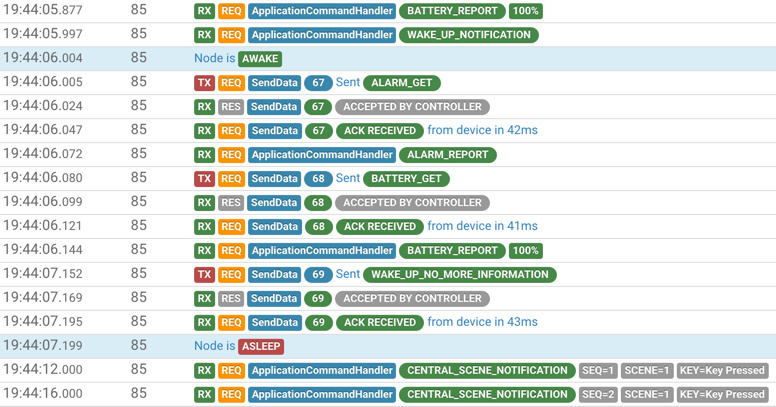

I’m not sure I can offer a lot of help. The following is from the log viewer, but it probably just reiterates what you already knew :frowning: .
The first press just seems to generate a wakeup and a battery notification - the binding then does some polling and the device goes to sleep. Looks fine.
The second and third presses generate the CENTRAL_SCENE notification.
I don’t know why - maybe there’s a setting since this device has a lot of configuration, although I didn’t see anything obvious in my very quick look. I don’t think there’s anything the binding can do to influence this though, so I don’t have any suggestions at the moment - sorry.
