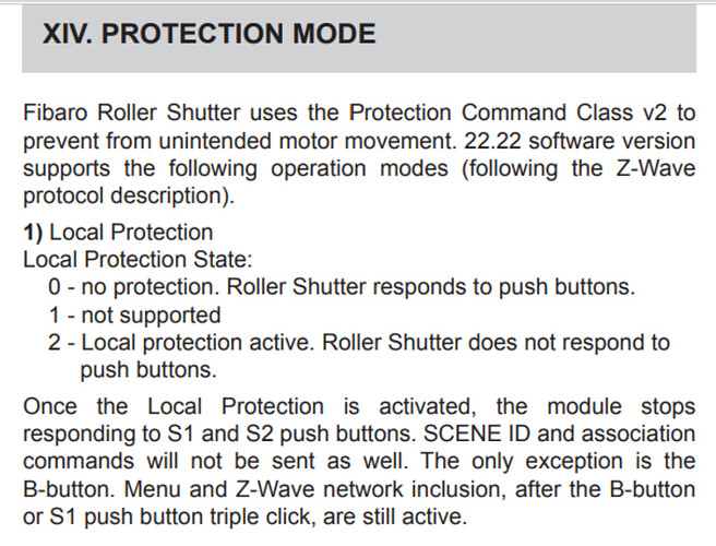

hey
some channel questions for users with that device
→ what is the channel switch_binary meant for?
→ sensor_power does report the watts; the channel meter_watts is not reporting anything and could be removed?
and maybe to @chris
is this feature a fibaro special or something that could be implented as a channel or config parameteR?
