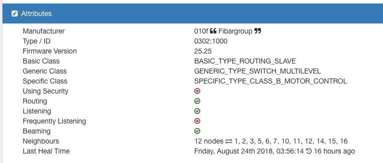

@mstormi mine is 25.25

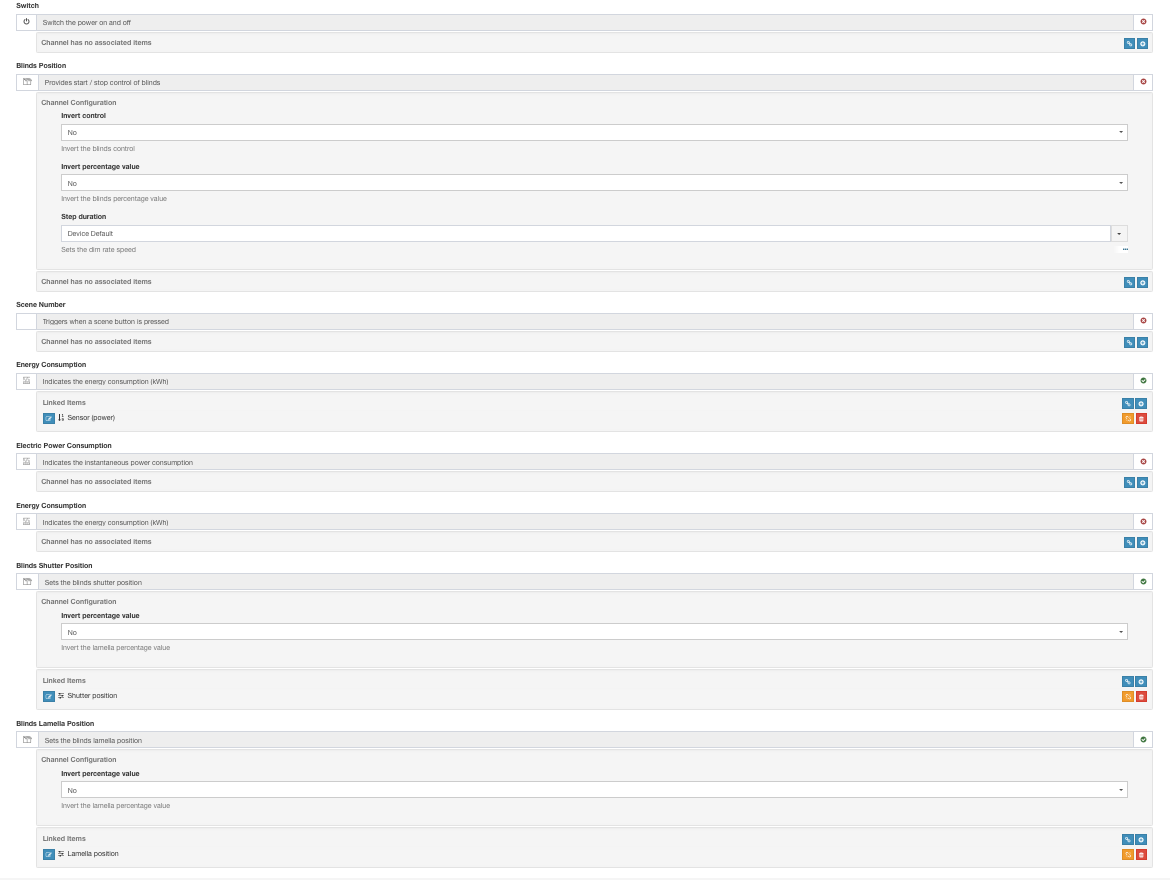

I need to use blinds_control instead of blinds_shutter to position the shutter.

FWIW, I’m using the blinds_control channel, not blinds_shutter (and blinds_lamella for tilt).

Note that blinds_shutter and blinds_lamella are of Dimmer type while blinds_control is of Rollershutter type.

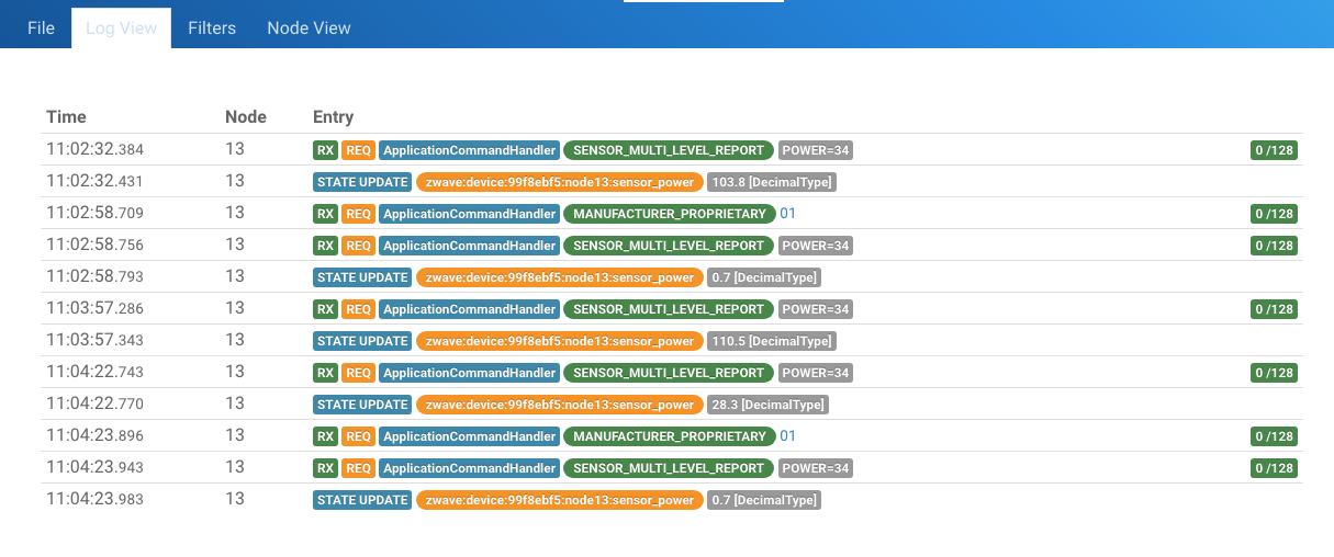

bad news - no feedback whatsoever from FGR-222 when using HW switches :frowning:

node13: network_e117085e__node_13.xml (16.9 KB)

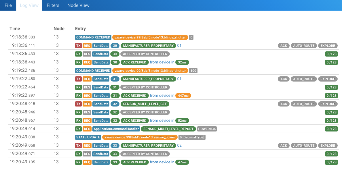

logfile when blinds are raised via openhab: openhab lower-raise.xml (38.6 KB)
logfile when blinds raised by HW switches: switch lower-raise.xml (198.5 KB)

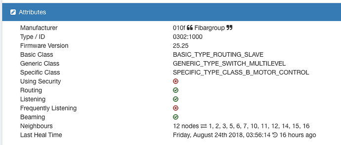

Additionally the HABadmin view of node 13:

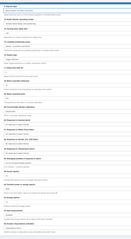

Open for any advise to change parameters.

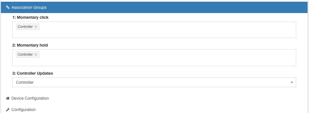

Unfortunately I’m not familiar with these devices. Reports are normally configured through associations - I don’t know if there’s another association group specifically for these reports, or if they are sent through the standard features like the lifeline. Unless the device sends something though, the binding can’t update itself.
Sorry - I know that’s not so useful, but I’m not sure what else the binding can do to resolve this - I would just suggest to update all associations to point them all at the controller and see if one of them starts the reporting.
with changing the associations groups to:

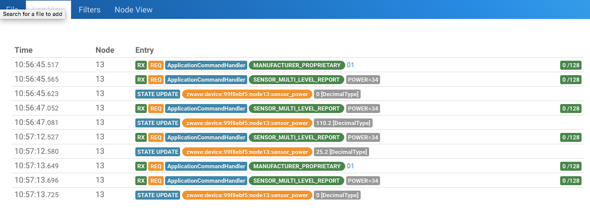

I am receiving updates from FGR-222 when using the HW switches:
node13_associations_set_up-down.xml (17.3 KB)
Additionally I changed “Self-Measurement” to active, to see which impact that setting has - unfortunately none :frowning:
node13_associations_set_self_measure_ON_down-up.xml (20.5 KB)
I guess the updates on shutter position and lamella tilt are hidden in the „MANUFACTURER_PROPRIETARY“ messages.
