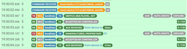

rule "Jalousien Sonnenschutz ein"
    Item Sonnenschutz changed from OFF to ON
	EgWz_JalousieSofa_Control.sendCommand(99) // Node 11
	EgWz_JalousieSofa_Lamella.sendCommand(60) // Node 11
	Thread::sleep(50)
	EgWz_JalousieLinks_Control.sendCommand(98) // Node 13
	EgWz_JalousieLinks_Lamella.sendCommand(60) // Node 13
	Thread::sleep(50)
	OgSm_JalousieFenster_Control.sendCommand(98) // Node 4
	OgSm_JalousieFenster_Lamella.sendCommand(60) // Node 4
	Thread::sleep(50)
	OgSm_JalousieTuere_Control.sendCommand(80) // Node 5
	OgSm_JalousieTuere_Lamella.sendCommand(60) // Node 5
	Thread::sleep(50)
	OgSr_JalousieFenster_Control.sendCommand(98) // Node 7
	OgSr_JalousieFenster_Lamella.sendCommand(60) // Node 7
	Thread::sleep(50)
	OgSr_JalousieTuere_Control.sendCommand(80) // Node 8
	OgSr_JalousieTuere_Lamella.sendCommand(60) // Node 8
	Thread::sleep(50)
	DgZr_Jalousie_Control.sendCommand(98) // Node 15
	DgZr_Jalousie_Lamella.sendCommand(60) // Node 15
According to me, the code of this rule should fit. Unfortunately this rule does not work stable. The shutters Node 5, Node 7 and Node 15 partly do not close.
once only Node 5, once Node 5 and Node 7, …
in case of a mistake, the shutters only make a very short movement and stop again immediately.
Z-Wave Log Node 5 if it works
Z-Wave Log Node 5 if it does not work
Does anyone have any experience with what this could be and how I can solve the problem? I am at the end of my rope and have no more ideas.
