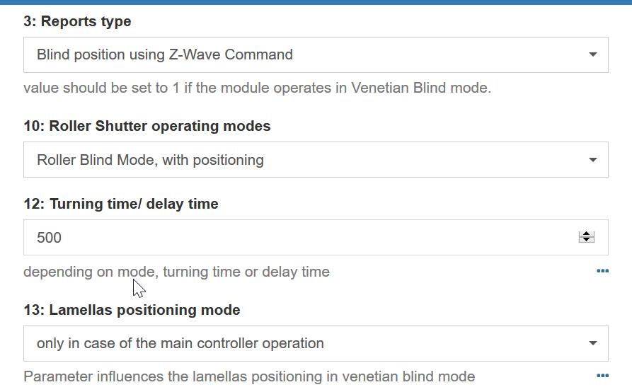

thanks again, you are my santa clause :slight_smile:
i read that, i have to set the parameter3 to 1(fibar command) and 10 to 2. but when i change the parameter3 to 1 i get always an error 500 internal server error .
i already turned off my items but it still appears
solved with the habmin :slight_smile: now i got the parameter 3 to 1.
but when i slide the dimmer to 0% nothing happens the same when i slide to 100% is the calibration wrong?
actually i have define the items in paper ui. now i try to define the items in the *.item file.
the functions up, down and stop works with this definition.
Rollershutter EgWz_JalousieLinks_Control "Jalousie Links [%s]" <rollershutter>  {channel="zwave:device:Razberry2:node15:blinds_control,command=switch_multilevel,invert_state=false,invert_percent=true"}
But i can’t invers the percent value with parameter “invert_percent”. i can set it to true or false, but it is always the same result. Is there something wrong in this item definition?

I try to control the lamella position of my venetian blinds with a fibaro fgm222 … but it just does not work. up and down is no problem, but changing the position of lamellas doesn’t work.
item-file:
Rollershutter EgWz_JalousieTV_Control "Jalousie TV [%s]" <rollershutter>  {channel="zwave:device:Razberry2:node17:blinds_control"}
Dimmer EgWz_JalousieTV_Control_Lamella "Jalousie TV Lamella [%s]" <rollershutter> {channel="zwave:device:Razberry2:node17:blinds_lamella"}
sitemap:
	Slider item=EgWz_JalousieTV_Control
	Slider item=EgWz_JalousieTV_Control_Lamella
parameters:
10 is set to 2 → venetian blind mode with positioning
3 is set to 1 → Blind position via fibar command
when i move the 1st slider, the blind goes up and down. when i move the second slider for lamella, nothing happens.
I just can not find the problem :frowning:
There’s at least two fundamentally different generations of the FGRM, I’ve got both of them working incl. lamella tilt.
For the older ones, I have param #10 set to venetian blind mode, but for newer ones, I have #10 set to 1 (“roller blind mode with positioning”).
And don’t set reports type (param #3) to Fibaro-proprietary but to standard ZWave. Fibaro-proprietary reports don’t work anyway (albeit IIRC positioning doesn’t work on older ones without this setting).
That would need to work purely locally, OH is not involved here.
I suggest you check your actuator’s parameters. #1 is ‘local protection’ which if enabled disables hardware switches.
That’s likely because reports sent in Fibaro proprietary format are not supported (properly decoded by OH). Set binding into debug mode to see the whole message in order to confirm this assumption.
Thank for your tipp … but my lamellas doesn’t work anymore. is the item and sitemap setting above ok?
i have test both parameters, but no luck. (venetian blind and roller blind)

I was using the OH 1 Z-Wave binding with the Fibaro proprietary reports (shutter position & lamella tilt values) since 2016.
Sure - check here (http://www.cd-jackson.com/index.php/zwave/zwave-device-database/zwave-device-database-guide).
I’m planning to switch from ioBroker to openHab, made myself familiar with the concepts and am now checking if all my requirements can be served via openHab.
There are three Fibaro Roller Shuters 2 in my setup, getting them to work is a must to switch to openHab.
I read this thread, updated to the latest 2.3 version (1251) and can see my devices being recognized.
I cannot see any channel related to the lamellas in Paper UI, I can see a “manufacturer_specific” entry in the node XML file.
Can anyone help me how I can set the lamella positions?
I’m happy to start a new thread, if preferred or handle it via direct messages, to not spam this thread.
Any help is highly appreciated.
Best
Daniel
You need to install the zwave development binding, that would give you a blinds_lamella channel in PaperUI.
Thanks a lot. I thought by upgrading openahb to 2.3.0-Snapshot, I would have this one already.
I can see the lamella now and will take it from there.
Appreciate the fast help :slight_smile:
Thanks for the information about development version … now it works fine.
My idea now is the use of rollershutter item (up/stop/down) AND the two sliders shutter and lamella.
It is possible to automatic refresh the position of the dimmers, if i move with up/stop/down?
